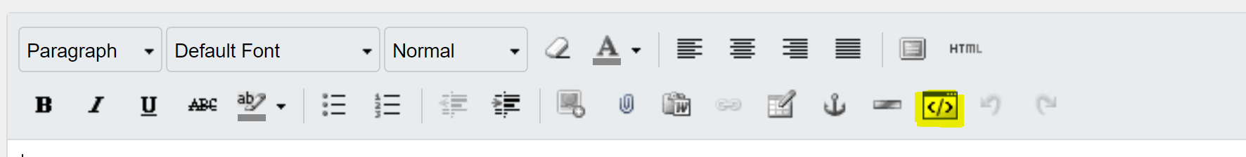

  • First, I edited your post by replacing your code with a version using the </> button shown in the picture below. When posting code snippets, using this option adds line numbers and C language formatting.
