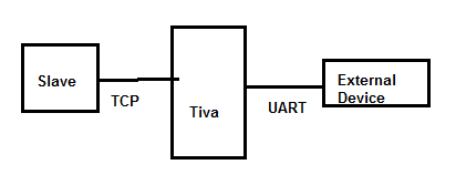

    enet_tcpecho server working perfectly. I need to fetch data from an external device via UART send that data via TCP/IP communication. The procedure is as follows
    1. Receiving command from the slave device via TCP to read external device
    2 Processing command
    3. Sending read request to the external device via UART
    4. waiting for data using while loop
    5. Receiving data via UART
    6. Send external device data via TCP to slave.

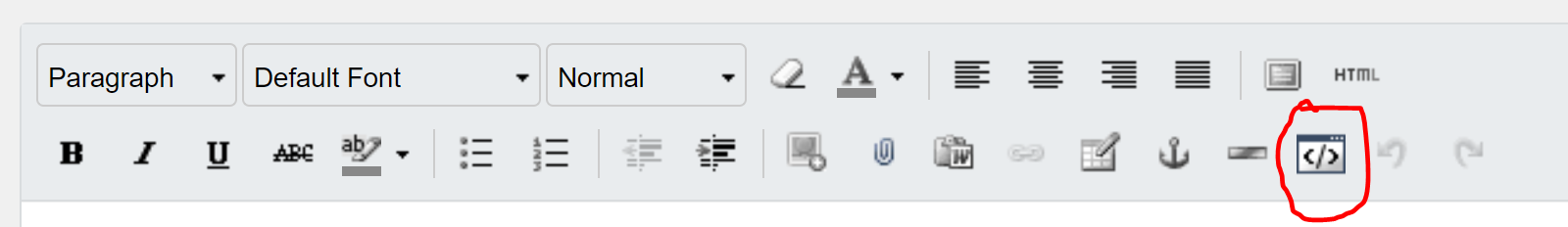

  • First, I edited your last post. I copied your C code and restored the indents. Then I used the </> button to paste the code back into your post. It makes the code much more readable.

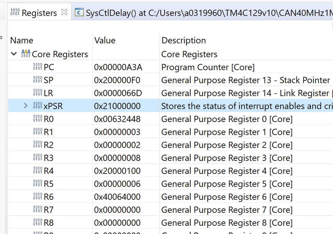

  • Would you please put a breakpoint on the while loop, and when the CPU halts at the breakpoint, check the value of the Processor Status Register (xPSR). I want to verify that you are not in an interrupt service routine.
