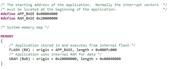

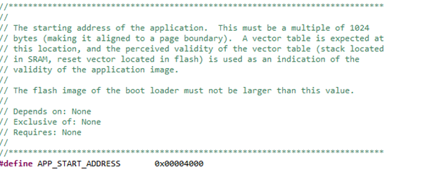

    For the second question, in the 'boot_emac_flash' program the starting address of the application at 0x00004000. (in bl_config.h) like image below:
     In the "boot_demo_emac_flash" program, in boot_demo_emac_flash_ccs.cmd file the starting address of the application is 0x00004000. see the image below:

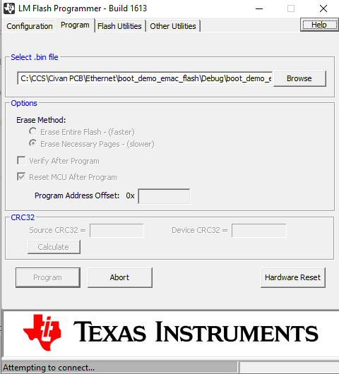

    But when I repeat steps 4 and 5 the LM Flash blocked. like the image below:
    i.e. LM flash did not send the new boot_demo_emac_flash.bin file.
    I hope my problem more clear now. Do you have any idea?

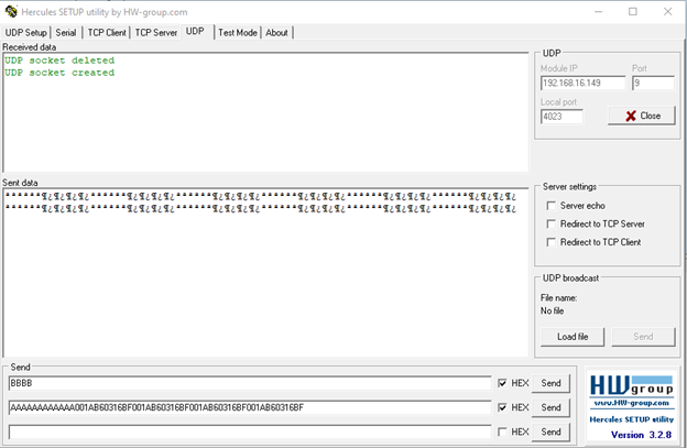

    Today I checked another process:
    I opened Hercules in the UDP tab I enter the Model IP and Port = 9. then I send the magic packet ("A*12 times + MAC address *4 times).
    You can see in the image below the magic packet:
    now in the LM flash I press on Program button and the program complete.
    So, I think that LM Flash doesn't send the magic packet to MCU's IP address.

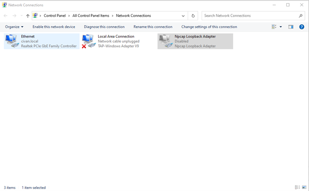

    Can you confirm one thing? If your PC only has one Ethernet interface then the LM flash programmer will correctly send the magic packet to that one? I think you can temporarily disable other Ethernet adapters in your Windows setting. If this is the case, then LM flash programmer is sending the magic packet to the wrong interface. As mentioned in the other posts you referred. While I understand the inconvenience it may have caused, there is currently no plan to update the LM flash programmer.
  • Thanks a lot!!
    This resolved my problem.
    When I disable the "Npcap Loopback Adapter" the LM Flash send all the data to the target.
    When I enable it, the LM blocked.
