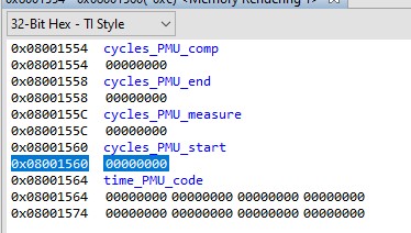

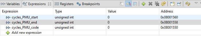

I'm trying to measure code execution time using PMU, I followed steps mentioned in "Execution Time Measurement for Hercules™ ARM® Safety MCUs" pdf.
But every time I get zero counter value. I'm using pmuCOUNTER0 to measure cycles.
I also checked the memory view, there also im getting 0 value.
Is there something i'm missing to implement in the code.
Please let me know how to resolve this issue.
Shantanu S.

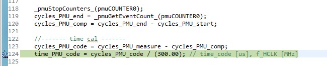

Bellow is code i am using to measure cycles:
#include "HL_sci.h"
#include "HL_sys_core.h"
#include "HL_sys_pmu.h"
#include "HL_sys_common.h"
volatile uint32_t cycles_PMU_start, cycles_PMU_end, cycles_PMU_measure, cycles_PMU_comp, cycles_PMU_code;
volatile float time_PMU_code;
int main(void)
    //------ init ---------
    _pmuInit_();
    _pmuEnableCountersGlobal_();
    _pmuSetCountEvent_(pmuCOUNTER0, PMU_CYCLE_COUNT); // PMU_INST_ARCH_EXECUTED
    //---- start -----
    _pmuResetCounters_();
    _pmuStartCounters_(pmuCOUNTER0);
    cycles_PMU_start = _pmuGetEventCount_(pmuCOUNTER0);
    asm(" NOP");
    asm(" NOP");
    asm(" NOP");
    asm(" NOP");
    asm(" NOP");
    asm(" NOP");
    asm(" NOP");
    asm(" NOP");
    asm(" NOP");
    asm(" NOP");
    //------ stop -----
    _pmuStopCounters_(pmuCOUNTER0);
    cycles_PMU_end = _pmuGetEventCount_(pmuCOUNTER0);
    cycles_PMU_measure = cycles_PMU_end - cycles_PMU_start;
    // ----- compensation -----
    cycles_PMU_comp = cycles_PMU_end - cycles_PMU_start;
    //------- time cal -------
    cycles_PMU_code = cycles_PMU_measure - cycles_PMU_comp;
    time_PMU_code = cycles_PMU_code / (300.00); // time_code [us], f_HCLK [MHz]
 while(1);
