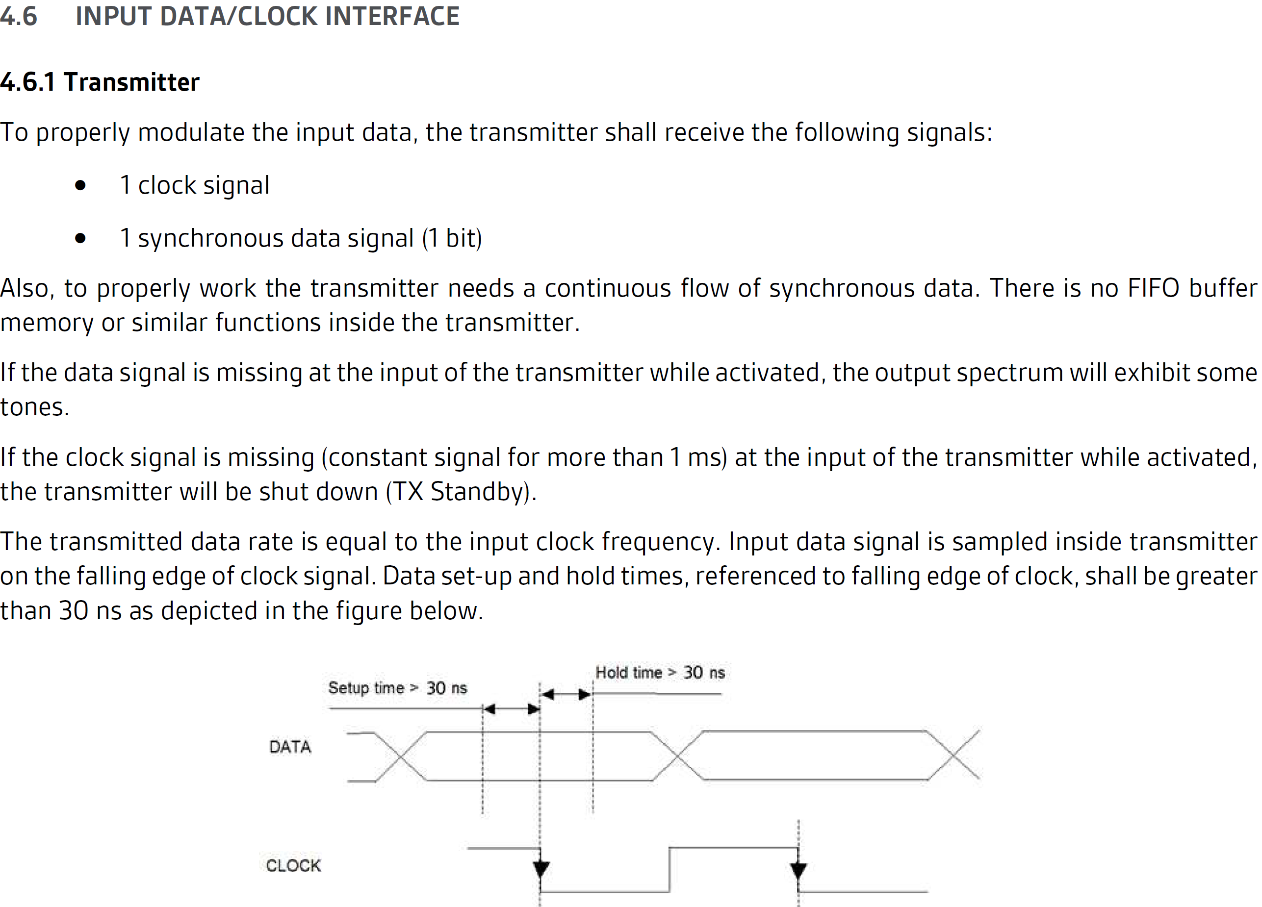

    PS: The attached is the timing requirement of the data and clock signal to the radio

    Thank you for your response Ralph. I'll try to attach the image again here.
    TLN

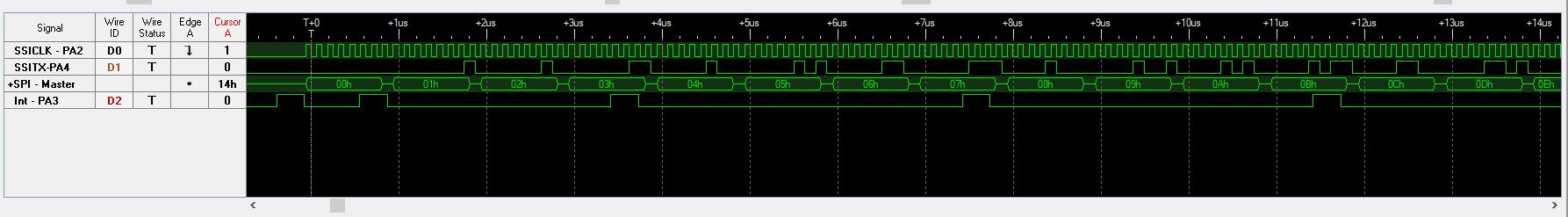

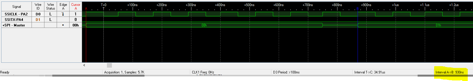

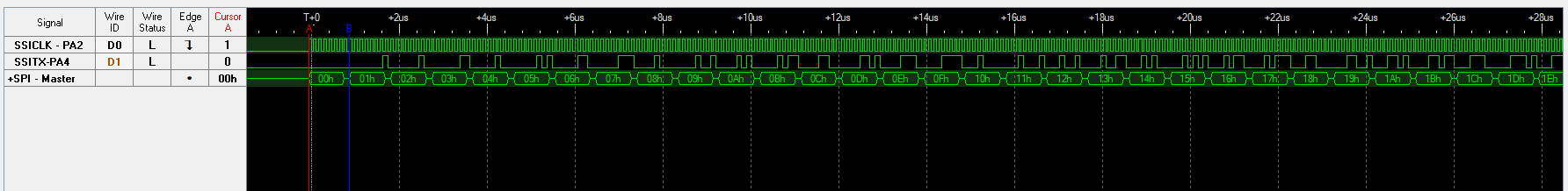

  • I can help you with setting up the uDMA, but first let's determine in SSI is a possibility or not. By using advanced mode, we can send a continuous clock as shown in the first image below.
    I am working from home so I only have a USB logic analyzer. The clock periods are all the same, but the logic analyzer resolution makes some of them look uneven when I try to capture a long string.
    There is a complication. Running at 120MHz system clock, the SSI is clocked at half that rate or 60MHz. 8MHz is not an even divisor of 60MHz. Therefore the actual baud rate I got was closer to 8.6M baud (60MHz / 7). To get more exactly 8M baud I need to run the system clock at 112Hz. How close to 8M baud must the data rate be? If 8.6M baud is good enough, I will proceed to calculate the CPU overhead with the bit reversal. If not, I will look into how to set the PLL to 112MHz.
        SSIConfigSetExpClk(SSI0_BASE, ui32SysClock, SSI_FRF_MOTO_MODE_0,
                           SSI_MODE_MASTER, 8000000, 8);
        SSIAdvModeSet(SSI0_BASE, SSI_ADV_MODE_WRITE);
        SSIAdvFrameHoldEnable(SSI0_BASE);
        // Enable the SSI0 module.
        SSIEnable(SSI0_BASE);

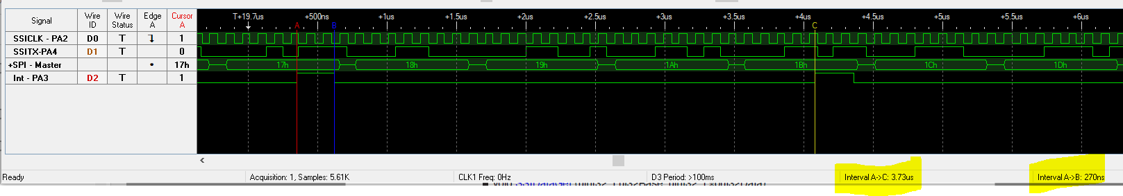

  • I went ahead and measured the interrupt overhead time using the CPU to load the SSI register. My initial run used an embarrassing 40% of the CPU time. Then I replaced the TivaWare calls with direct register writes in the interrupt routine and got the interrupt time down to 7.2%. I am measuring an I/O pin (GPIO PA3) to determine the interrupt time. The time measured includes one write to the GPIO pin register, but does not include the entry and exit to the interrupt routine.
    The interrupt routine looks like this:
    void SSI0_intRoutine(void)
        unsigned int i;
    //  GPIOPinWrite(GPIO_PORTA_BASE, GPIO_PIN_3, GPIO_PIN_3); // pin high
        HWREG(0x40058000 + (GPIO_PIN_3 << 2)) = GPIO_PIN_3;
        // stuff 4 more characters in the SSI FIFO
        for(i = 0; i < 4; i++)
    //      SSIDataPutNonBlocking(SSI0_BASE, TableBitReverse[pui8DataTx[index++]]);
            HWREG(SSI0_BASE + 8) = TableBitReverse[pui8DataTx[index++]];
        if(index >= NUM_SSI_DATA)
            index = 0;
    //  GPIOPinWrite(GPIO_PORTA_BASE, GPIO_PIN_3, 0); // pin low
        HWREG(0x40058000 + (GPIO_PIN_3 << 2)) = 0;
    I have exported by CCSv10 project into a .zip file and attached it for your reference.

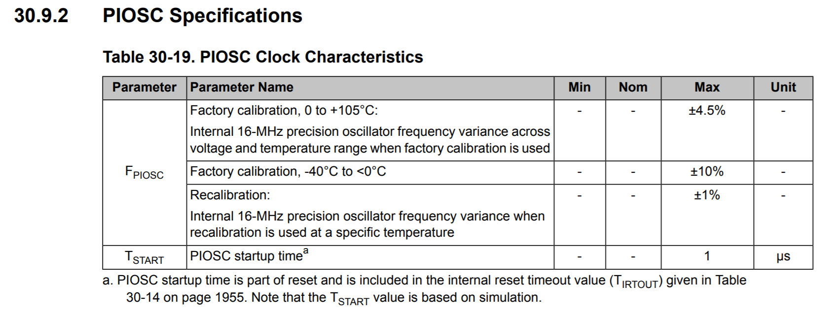

  • I realized that we can come closer to 8M baud by using the 16MHz PIOSC (precision internal oscillator) as the SSI clock source. The specified accuracy with the factory calibration is shown in the table below:
    To do the recalibration, your design must have the 32.768-kHz external crystal. My board using only factory calibration at room temperature showed very close to 8MHz baud rate:
    The modified project is attached:
    /cfs-file/__key/communityserver-discussions-components-files/908/7713.SPI_5F00_Bit_2D00_reverse.zip
