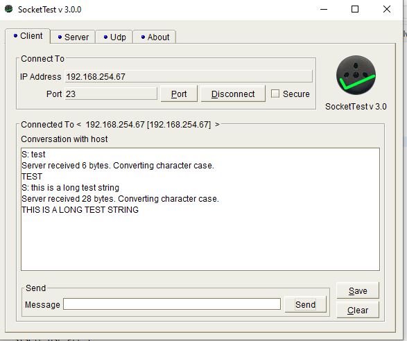

  • I run the tcp_echo_server with static address and I don't see a problem.  My static address is 192.168.254.67. On the client side (i use SocketTest tool), I send a short string 'TEST" that is less than 10 characters and another string 'this is a long test string' which is longer than 10 characters and both works. The server echoes back with the converted case in both cases.
