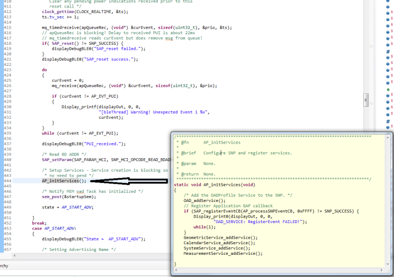

Our design is based on oad_firmware_update_MSP432P411 which we changed to MSP432P4011. In the figure below we added Services which are similar to the first "OAD_addService" but without registering for connection events i.e. SAP_registerEventCB(AP_processSNPEventCB, 0xFFFF).
We notice that everything works but the OAD! If we leave out these service OAD works fine? What should we look for? Must these XXX_addServices been done elsewhere?
We have asked this 1 year ago but didn't receive an answer then! We added it here because SAP_open(&sapParams) was done here! Or should they be registered in another context? We really want to solve this now. Which document could we look at?

    I removed last reply since I recently solved the problem. I already suspected that the problem was related to a short of RAM, due to the behaviour I saw. I used the CACHE_AS_RAM getting an additional 8k of retaining SRAM which solv. What I want to ask you is if the predefines in "simple_np_cc2640r2lp_stack_library":
    GAP_BONed the problemDINGS_MAX and GAP_CHAR_CFG_MAX represent ALL characteristics, thus inclusive the characteristics already declared in "simple_np_cc2640r2lp_app" (DeviceInfoService, GenericAccess and GenericAttribute) or just additional characteristics which are registered by the MCU?
