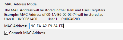

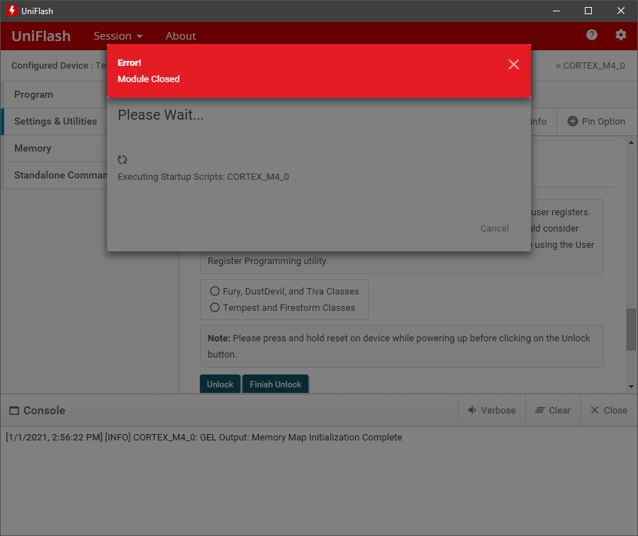

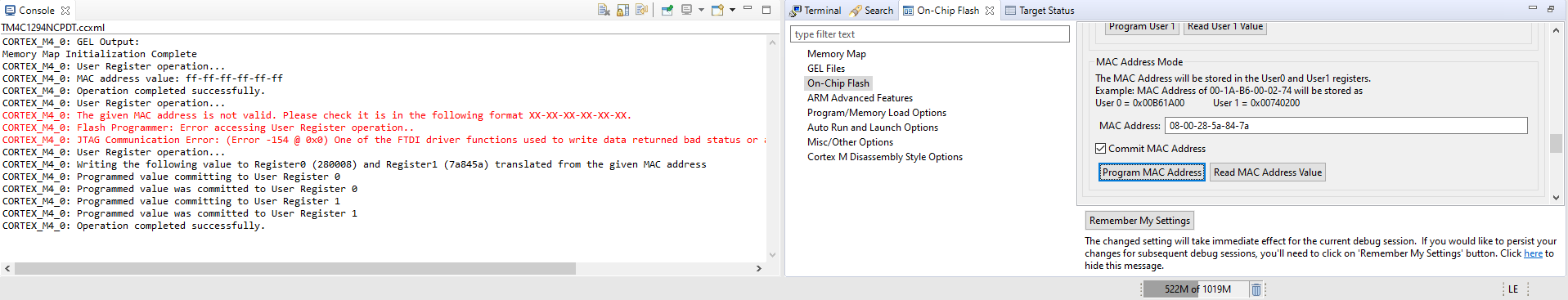

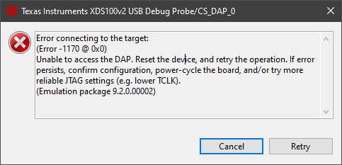

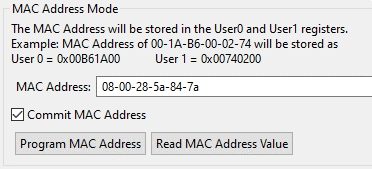

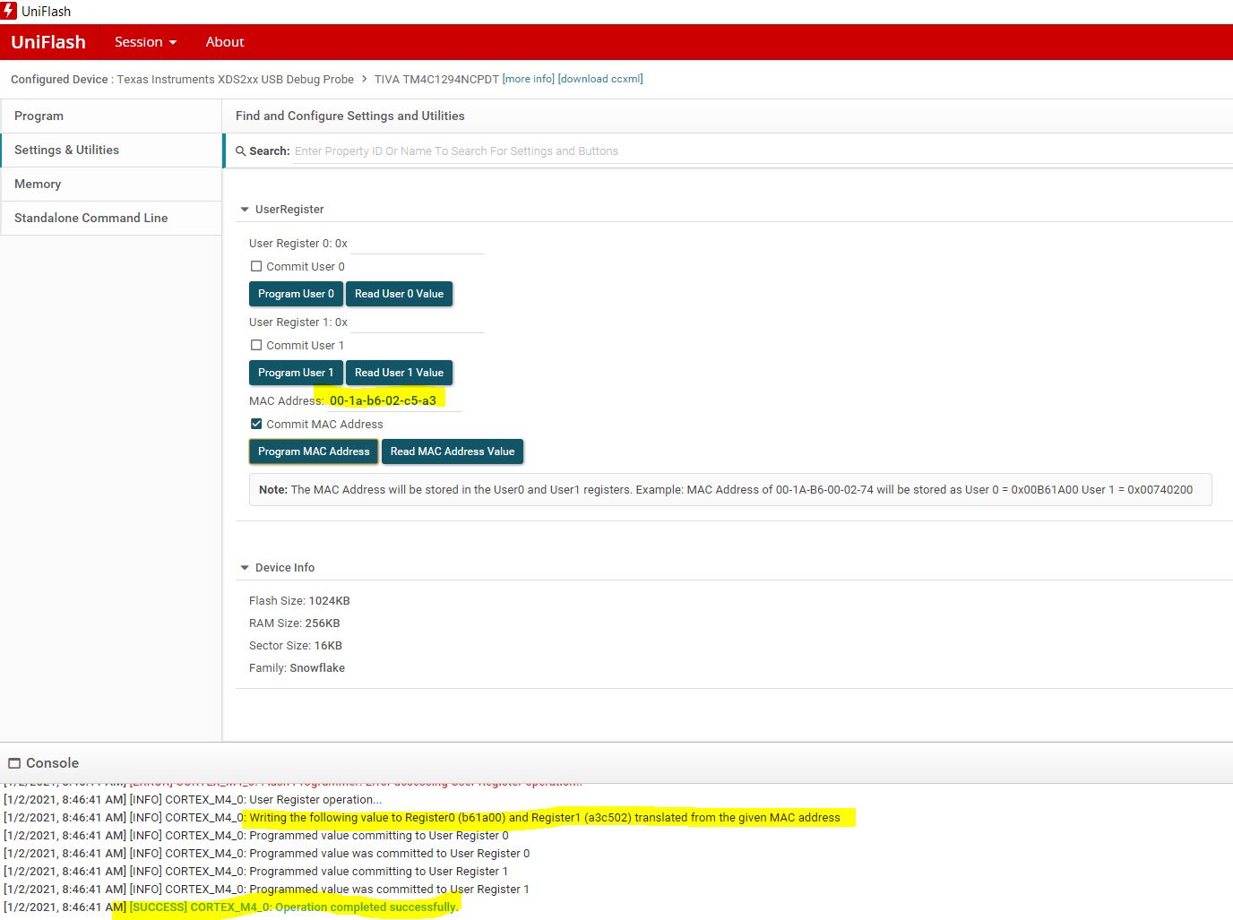

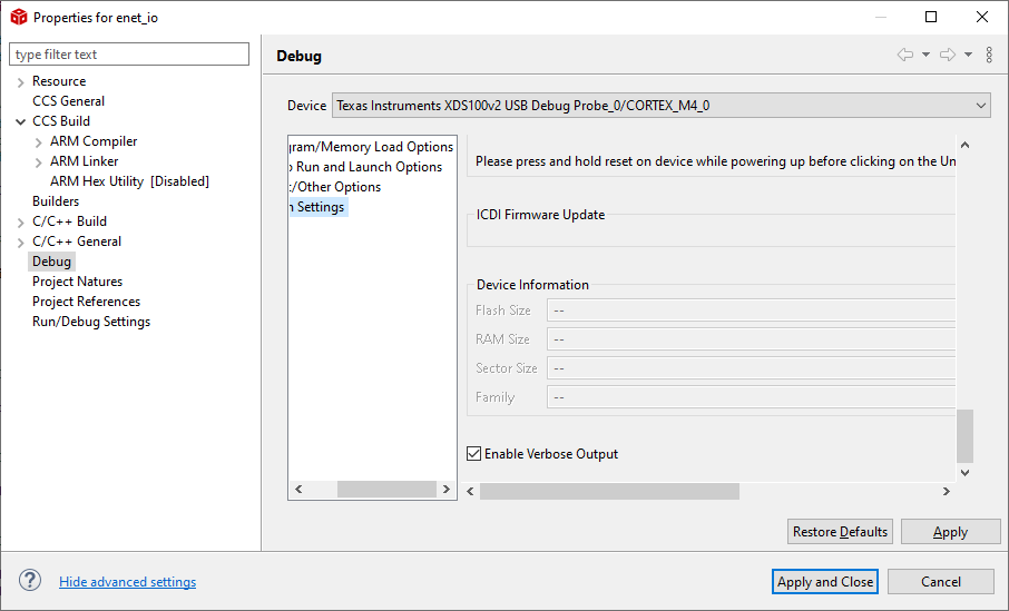

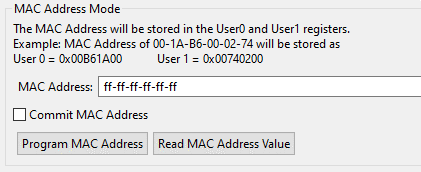

I am attempting to program a custom board using a TM4C1294NCPDT microcontroller and a XDS 100V2 debugger. I was previously able to program the microcontroller via CCS successfully. The debugger was working correctly and the program halted at , however I needed to flash a mac address into user memory. After attempting to flash a mac address using UniFlash CCS will no longer program the MCU. I am getting the following error message,
I programmed in the following mac address using UniFlash, 9C-EA-A2-E9-2A-FD.

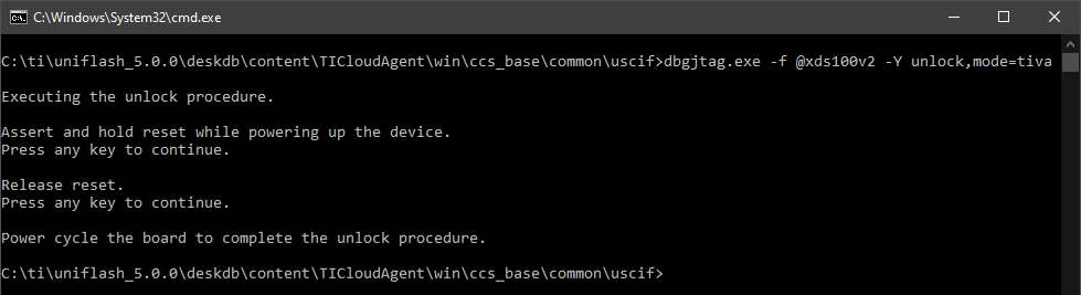

I have tried power cycling the board and putting the RST pin of the MCU low to no avail.

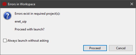

I am not sure if this is related, but CCS will successfully build the project and report that errors are still present only in debugging mode. I was able to program the MCU and watch the execution even though CCS thought there were still errors.
I realize that this error message can have many different causes and have attached the MCU schematic, and the project build output.
