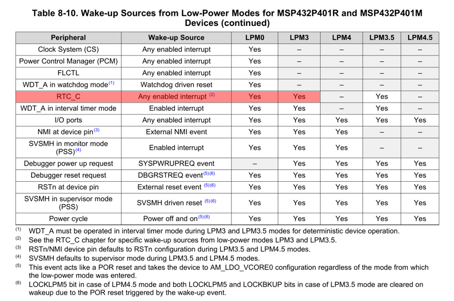

I use MSP432P401R.
I have a question about how the RTC works in LPM3.
I want to realize the operation to exit the LPM3 by the interrupt of RTC.
1. Create a thread_A in TI-RTOS
2. Make pending using sem_wait in thread_A
3. CPU is sleeping on LPM3 while pending thread_A
4.  Exit the LPM3 by alarm interrupt of RTC
After step 3, when checking the register, RTCHOLD of RTCCTL13 is changed from 0 to 1 in RTC_C.
Why RTC is disabled after step 3 ?
Below Table 8-10, I think RTC_C is avalable in LPM3.
I would appreciate it if you could teach me about  causes and alternatives.
