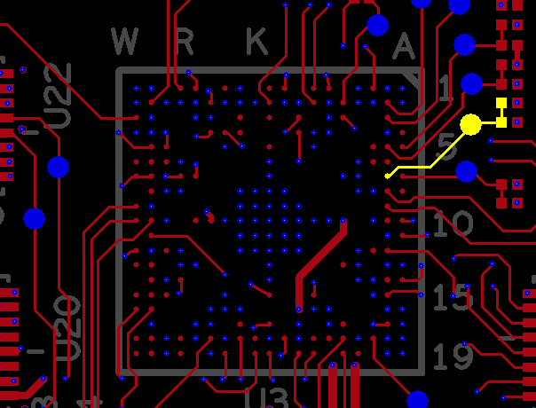

Customer is developing TM4E129BNCZAD MCU in their application, they found PE7 doesn't work in GPIO mode, the schematic is very simple in PE7 port, only pull up and pull down resistor in external circuit.
They are using the same initial code and GPIO operation code in both PE6 and PE7, PE6 works fine, but PE7 doesn't work.
You can see PE7 marked in yellow, if PE7 configured as OUTPUT, software can not output high or low normally, if PE7 configured as INPUT, the external pull-up resistor is mounted and pull-down resistor is removed, software read is still low.
They also tried to measure the impedance of this pin, it's normal as other pin.
Do you have any suggestion about this issue, thanks in advance.
