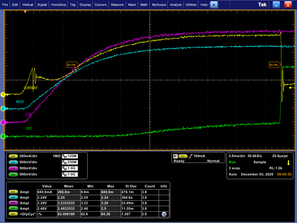

    The specific failure occurs on about 5% of our systems and only at hot temperatures (45C-70C). For the units that have this failure mode, it is very repeatable at the specific temperature of failure. During this failure mode, excess current pulse on VDD33 of roughly 1A lasts for about 15 ms, and the unit does not function (probably due to current limit). On rare occasions (intermittently) the 1A pulse will drop quickly after about 12ms and the unit will recover and function. This recovery mode is only possible if we increase the power supply current limit to 1A, and even then only intermittently.

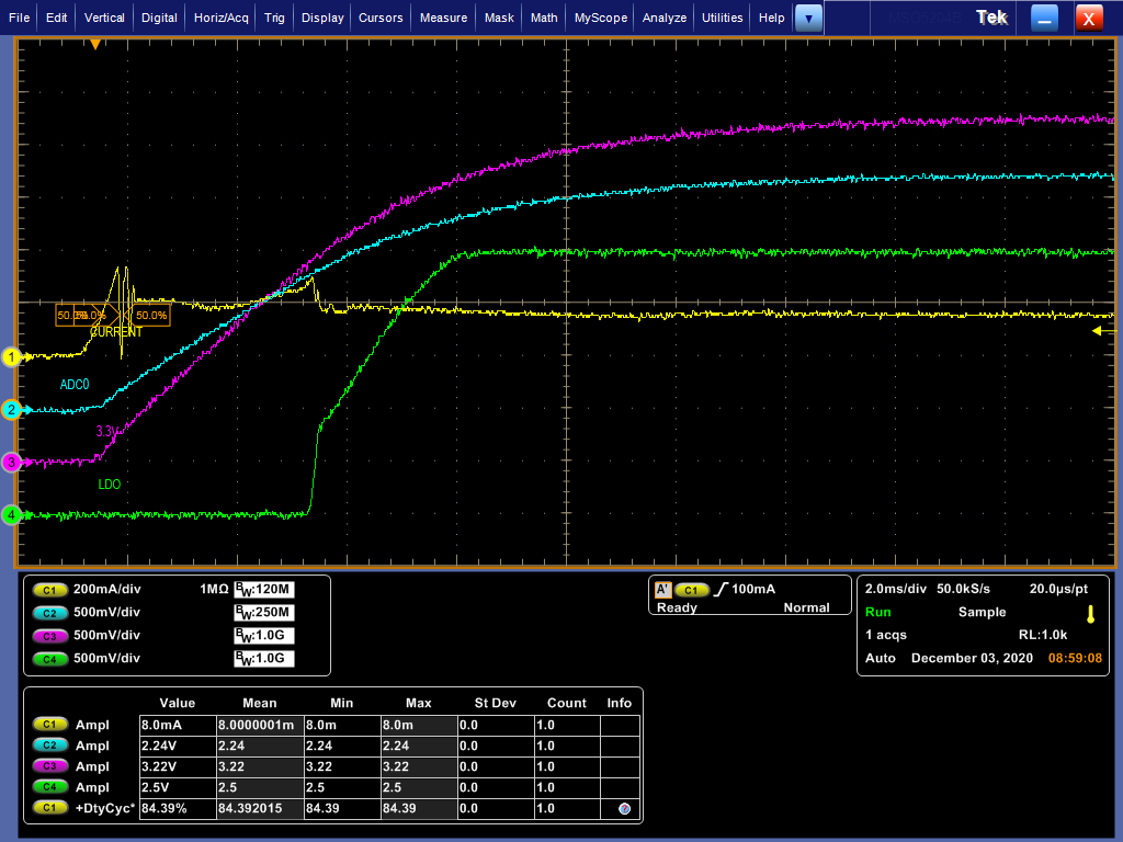

    We have probed the LDO voltage, and during the failure the LDO rise to 2.5V lags the VDD33 rise to 3.3V by roughly 15 ms. Normally LDO lags VDD33 by only about 2 ms.

  • I'm sending you graphs of of VDD and LDO power on waveforms. One that shows normal behavior and a second that shows our current pulse behavior. The first normal waveform shows LDO follows VDD pretty closely. The second shows LDO lags VDD by quite some time (15 ms).
