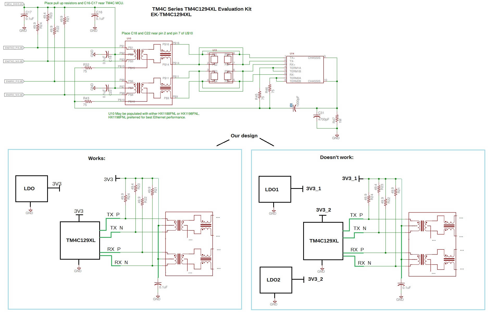

Hi!
We have used TM4C1294XL microcontroller with Ethernet in our design as it was done in your evaluation board. The problem is: if we use two LDOs with same part numbers (the first - for MPU supplying and the second - for termination resistors and transformer midpoint), Ethernet doesnt work. It works only if MPU and termination resistors are supplied with one of the LDOs 3.3V or two coupled in parallel (See the scheme below). Maybe, you can answer, why? And how can we make it work with two independent supplies, however, if it's possible?
