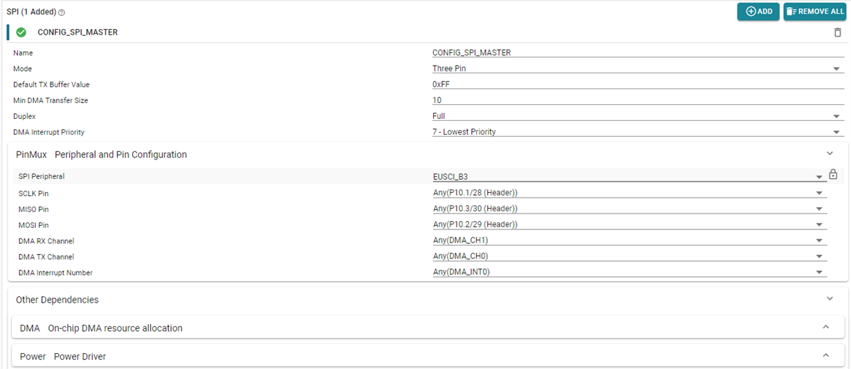

    I believe it will break just by changing the Spi bus from EUSCI_A1 in the Syscfg to EUSCI_B3.  For my testing purposes I also commented out the GPIO handshake since I don't have two demo boards and I am instead going straight into my Oscope that will decode spi.
    Here a screenshot of my syscfg

    Thanks for sharing the additional details and especially the screenshots. It really helps debugging issues like this!

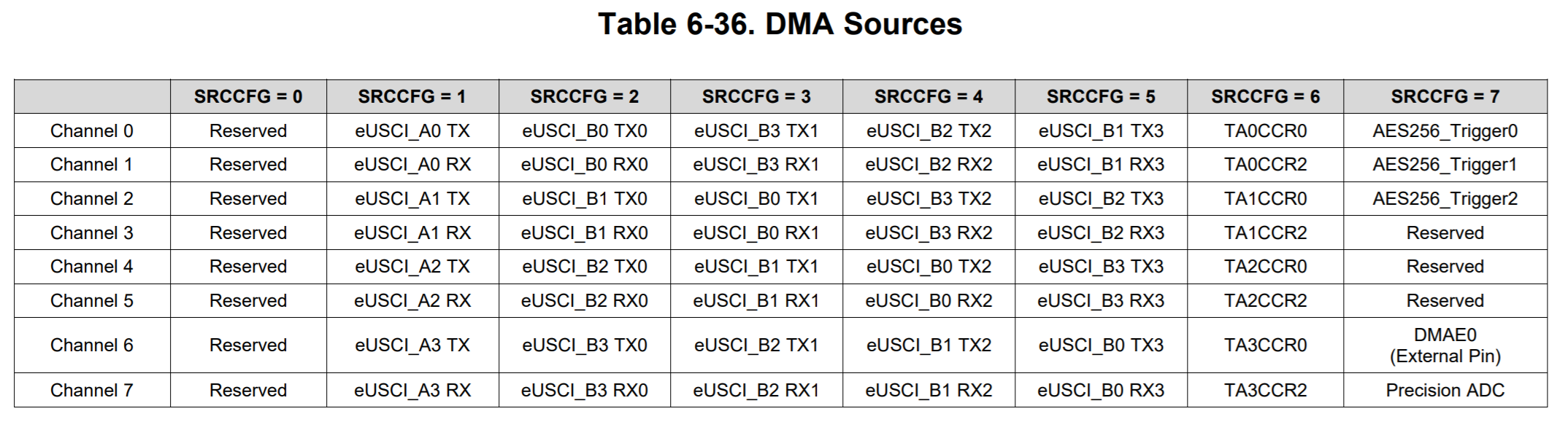

    I think I understand why this is happening. Looking at Table 6-36 from the datasheet, you'll notice there are TX, TX0, TX1, TX2 and TX3 sources. The same applies for RX. The DMA sources that end with 1, 2 and 3 only apply to the I2C mode which supports 4 different slave addresses. When using SPI or UART, only the DMA sources such as TX/RX and TX0/RX0 are applicable.
    In SysConfig, can you try changing the following parameters and see if the code works? Keep SPI Peripheral = EUSCI_B3.
    • DMA RX Channel = DMA_CH7
    • DMA TX Channel = DMA_CH6
    • DMA Interrupt Number = DMA_INT2 (see comments below)
    For the DMA Interrupt Number, you may want to use an interrupt other than DMA_INT0 since it's mapped to the logical OR of all completion events except those that are already mapped to DMA_INT1, DMA_INT2, or DMA_INT3 according to Section 6.5.2 in the Technical Reference Manual.

    That was it.  Its working great now.  I looked at this table earlier and tried changing the DMA channels, but I chose poorly.
    Avery
  • Hi Avery,
    That's great! Thanks for letting us know. The numbers appended to the end of the TX or RX aren't clearly defined in the table so don't feel badly about your initial choice. Have a great day.
