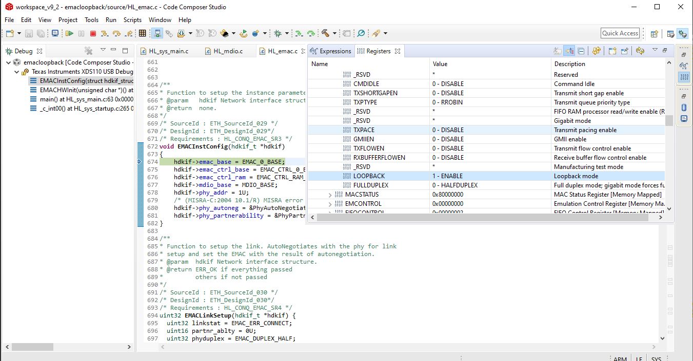

  • Hi QJ,
    I am trying to execute the loopback program from HALCOGEN examples and have connected the RJ45 connector in this format : Tx+ to Rx+ and Tx- to Rx-.
    The program enters infinite loop while executing MDIOPhyRegRead function and link is not established. I have attached my settings and code for your reference. Kindly suggest further.
