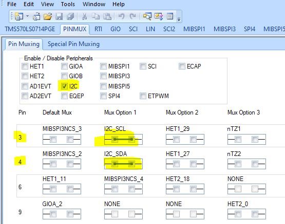

I am trying to I2C communicate a launchpad TMS570LS12x as a master and an arduino as a slave. I am using the sample code above, they are just example. I am using pin 9 and 10 of J6 of the launchpad for I2C communication and A4 and A5 on arduino fot SDA and SCL.  They do not communicate, Seems to be a launchpad programming problem because due to the two pull up resistors, I always see 3.3V in bouth lines with the oscilloscope. Moreover, using the CCS debbugging, I go into an infinite loop when I try to send data from Launchpad to Arduino. I would like to ask if I should select wich I2C port I have to use in the launchpad as there are 2 I2c port, and how I do it. I think I should not define registers as I am using halchogen library, but should I define some register for I2C? What could be the problem on having always high signal on I2C line and going in an infinite loop?

    This device has only 1 I2C module. Since the I2C signals are open-drain/open-collect signals, the I2C signals should be pulled up to 3.3V. When the bus is free, both pins are high.

    you should see the start bit, and the slave address on I2C SDA line. I have no idea about the code in your I2V slave side.
  • Thank you for the answer Wang. I have defined the slave address as 0x4 in CCS and as Wire.begin(4); in arduino. Could you explain me better how to define the start bit? where can i find documentacion about? In the reg_i2c library it is defined as:
    #define i2cREG1 ((i2cBASE_t *)0xFFF7D400U)
    In the datasheet od TMS570LS1224 section 8.6 I fuond some ID, I don't know if I should find the start bit there.
    Bouth lines (SDA, SCL) are pulled up to 3.3 V with two 1k resistors.

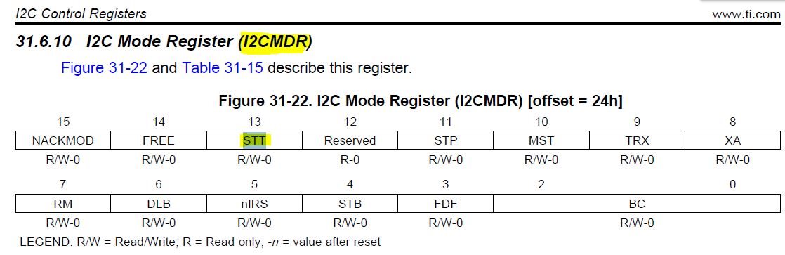

    In master mode, setting STT bit of I2CDMR register to 1 generates a START condition.
    Start condition: is defined as a high-to-low transition on the SDA line while SCL is high.
  • Sorry, I am not finding the bit and register you are talking of. I have looked at reg_i2c.h, i2c.h and i2c.c. Can you tell me where they are?
    I am using the function i2cSetStart(i2cREG1); as defined in Halcogen. Where the function is defined like this in i2c.c:

  • Yes, i2cSetStart() will generate the start condition. I2C->MDR represents the I2CMDR register listed in TRM:
  • The funtion i2cSetStart() seems to work right. The register change from:
    Default:3616
    Hex:0x00000E20
    Decimal:3616
    Octal:07040
    Binary:00000000000000000000111000100000b
    to:
    Default:11808
    Hex:0x00002E20
    Decimal:11808
    Octal:027040
    Binary:00000000000000000010111000100000b

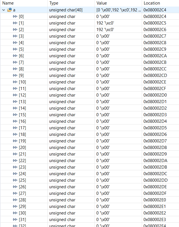

    But I still can't see any signal on the i2c lines with the oscilloscope.
    Even if the slave was wrong, shouldn't I see even a CLK signal sent from the Launchpad to the slave?
  • I am not understanding if the launchpad is working correctly. If I use the code to toggle a led it works.
    gioToggleBit(gioPORTB, 1);
    for (;;) { gioToggleBit(gioPORTB, 1);
    for (i = 0; i < DELAY_VALUE; i++); }
    If I try to put high a GIO it doesn't:
    gioSetBit(gioPORTB,3,1);
    gioSetBit(gioPORTA,0,1);
    gioSetBit(gioPORTA,1,1);
    When I check with the oscilloscpe:
    J5 pin 4: GIOB_3
    J4 pin 9: GIOB_1
    J4 pin 10: GIOB_0
    This is the whole code I am using just to try if the launchpad is working:

    Can you also confirm me that SCL is the pin8 J11 and SDA pin 9 J11?
  • You can use either pin8/9 on J5 or Pin8/9 on J11.
    The device pin 3/4 used by I2C, MibSPI and N2HET. Please configure the pinmux properly to use those pins for I2C.
  • Thank you so much for the answer, but how can I configure pins 3/4 as I2C?
  • This was the problem. Now I can communicate the TI as a master with an arduino as slave.

    But it still doesn't work. Maybe I am not converting correctly the value of the 32 bits into a 8 bits. How should i do that?
    In the last case, it send the buffer1, then SDA stay at 3.3V and SCL at 0V, I sends the buffer2, It sends anothe package and finally SDA and SCL stay at 3.3V. The other 2 buffer can't be sent.
    uint32_t b[10];
    uint8_t a[40];
    for(i=0; i<10; i++){
         a[i*4+0] = (b[i] & 0xFF000000)  >> 24;
         a[i*4+1] = (b[i] & 0x00FF0000) >> 16;
        a[i*4+2] = (b[i] & 0x0000FF00) >> 8;
     a[i*4+3] = (b[i] & 0x000000FF);
    data_count=40
     i2cSetCount(i2cREG1, data_count);
    i2cSend(i2cREG1, data_count, &a[0]);
    Please read the I2C chapter for using I2C protocol.

    1. The stop condition is generated when ICCNT passes 0 when the I2C is in non-repeat mode (RM=0).
    2. The stop condition is generated if STP bit is 1 In repeat mode (RM=1).
