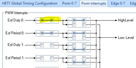

Using HalCoGen to set PWM:
setting direction on N2HET1[0]:
enabling interrupts HET high level:
Enabling IRQ VIM channel 10:
Of course in "PINMUX" i choose NHET1[0] for pin 25.

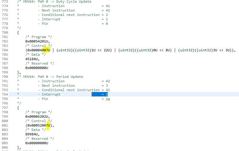

Using the debugger I can see that the execution arrives correctly in pwmNotification but the variable "notification" passed to it has always the value 4U (pwmEND_OF_PERIOD) and never 2U (pwmEND_OF_DUTY). So the instruction SetQorvoOnOff(OFF) is never executed.
SetQorvoOnOff() is a very simple function, acts on a single GPIO, pin 125 configured as N2HET1(14).
It seems that the event "end of duty" is never captured.
