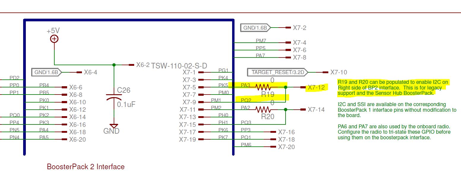

If I send a '1' out on PortA pin 3 (0x08 or 0xEA for instance), PortQ pin 2 apparently is also set!?
And PortQ pin 2 is supposed to be input! Not the case any more, it seems. I have a switch connected to Q2, and the above loop mirrors the state of the switch, until a 1 is written to PortA bit 3.
I have been through all 8 bits on portA one by one. Only when bit 3 is set, I see this.
What am I doing wrong?
Or, what can I do about it?
