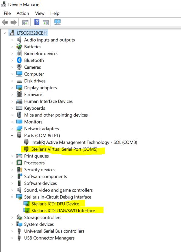

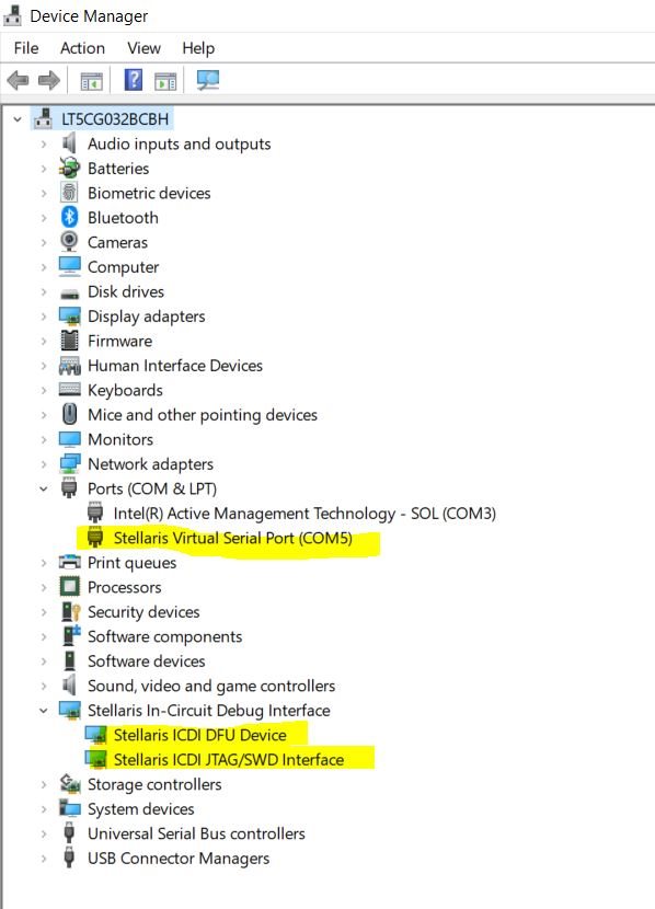

Since then, I can't go back to CCS and use the Stellaris ICDI interface.
I changed EKs. In the device manager I can see the Stellaris VSP.
I tried flashing blinky from CCS to this EK. It appears to start using the Stellaris ICDI and
then stops saying it can't connect to the target.
Is there a way to exit dfuprog.exe? device 0 is still in run time mode and I don't
know how to exit this.
I appreciate any information that fills in missing gaps in my understanding here.
Priya
  • Hi Priya,
      The post that you reference explains exactly what happened. As mentioned in that post, once you flash and run the boot_serial in USB mode, the MCU enumerates as a DFU device. However, the ICDI debug probe is also another DFU device. Therefore, if you use dfuprog you will see two DFU capable devices. You must have chosen the incorrect DFU device and update the ICDI controller with the boot_demo_usb and hence the ICDI controller is no longer acting as a debug probe.
      You can verify this again by going to the device manager. You should see the Stellaris IDCI JTAG/SWD Interface and Stellaris ICDI DFU Device in a normal LaunchPad. If you do not see this, the ICDI controller is destroyed in the sense that you can recover it. There is a bootloader inside the ICDI controller too. That bootloader is overwritten with the boot_demo_usb program. It will not enumerate as a DFU device anymore and it will not take another update either.
    In the boot_demo_usb.c file, there is an IMPORTANT note written about doing DFU update. There is really nothing you can do at this moment. I would suggest you move on to another LaunchPad to continue your development if you want to use the ICDI debug probe. If you have an external debug probe like XDS100 or XDS200 you can use them to connect to the target. If you do use a new LaunchPad, please be very careful to choose the correct DFU device before you update the application. The safest way will be to provide external power to the LaunchPad and have the ICDI Debug port disconnected. This way there is only one DFU device shown up.
