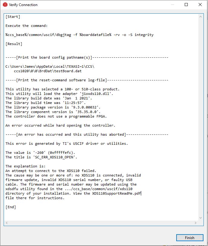

    I have installed CCS v10.2.0 and have restarted the PC. However, the XDS110 device is not detected by the desktop PC. Also I have tried the commands for checking the XDS device. The screenshot of the same is as below.
    James
  • James,
    The picture didn't came through. Can you please post the image again?
    Is OP8665 like dockstation?

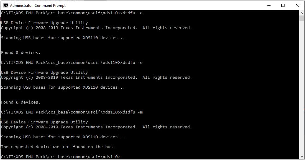

  • Hi Santosh,
    The picture was the screenshot that I took after executing the command xdsdfu -e in the command window after installing CCSv10 and then connecting XDS-110.
    The result of this execution was that there were no devices detected.
    James

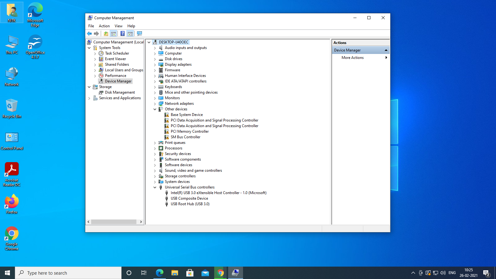

    Can you check the Windows Device manager? Do you see XDS110 device?
  • Hi Santhosh,
    Thank you for the reply.
    XDS 110 is not appearing in the Device manager.
    Thank you

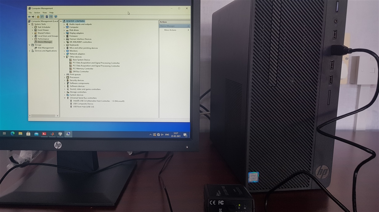

  • Hi Santosh,
    Thank you for the reply. I have tried connecting the XDS-110 to the USB ports of the PC both front and rear. However, there was no change observed in the device manager. I could only see a green light (D1) turn On when the device was connected to the USB port. I am using the USB cable supplied with the Debug probe.
    The detailed snap shot is attached.
    James

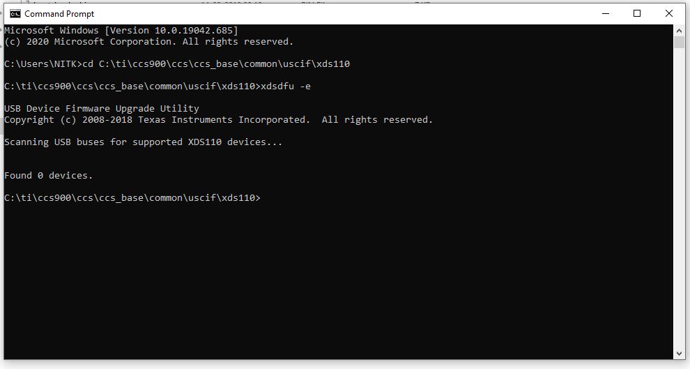

  • Hi Santhosh,
     I have downloaded the "ti_emupack_setup_9.2.0.00002_win_64.exe" and installed the same as I have installed "Code Composer Studio 10.2.0".
    I have connected the XDS110 probe to the desktop PC and have run the command 'xdsdfu -e'  commnad from the command window and I have also tried creating a CCS project and then verifying the connection to the XDS 110, the results of the two are as attached.
    Request you help in this regard.
    Thank you
    James

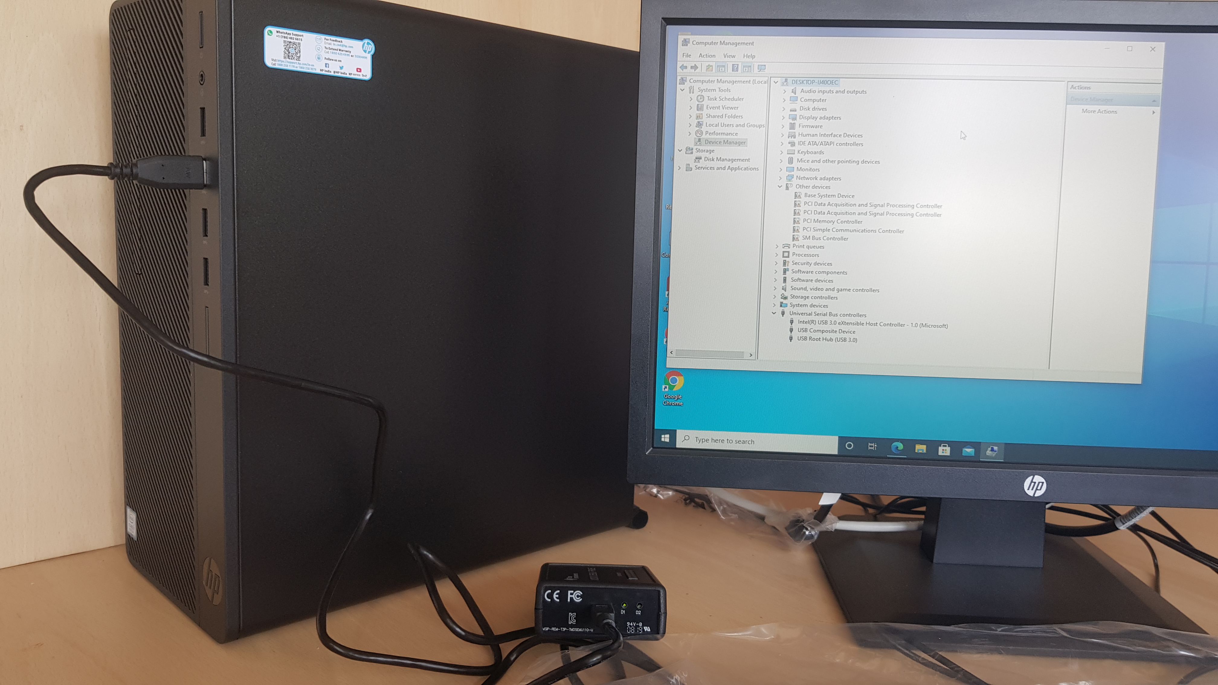

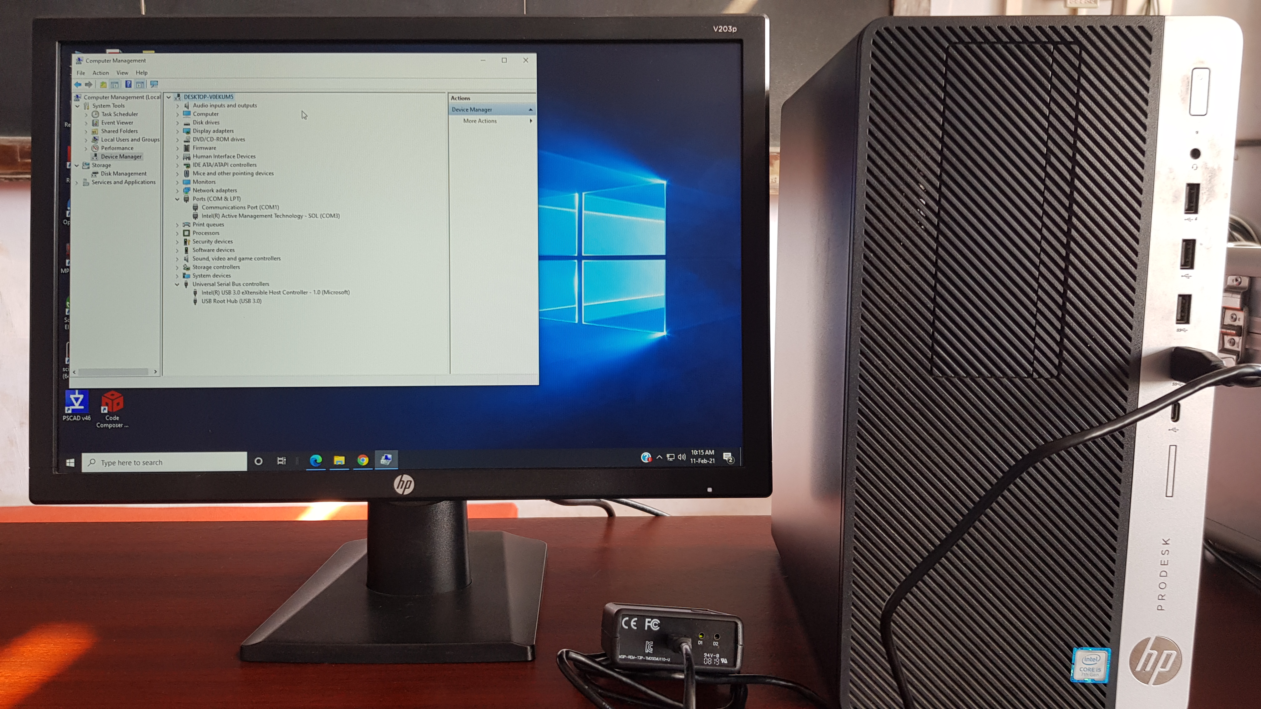

  • Dear Santhosh,

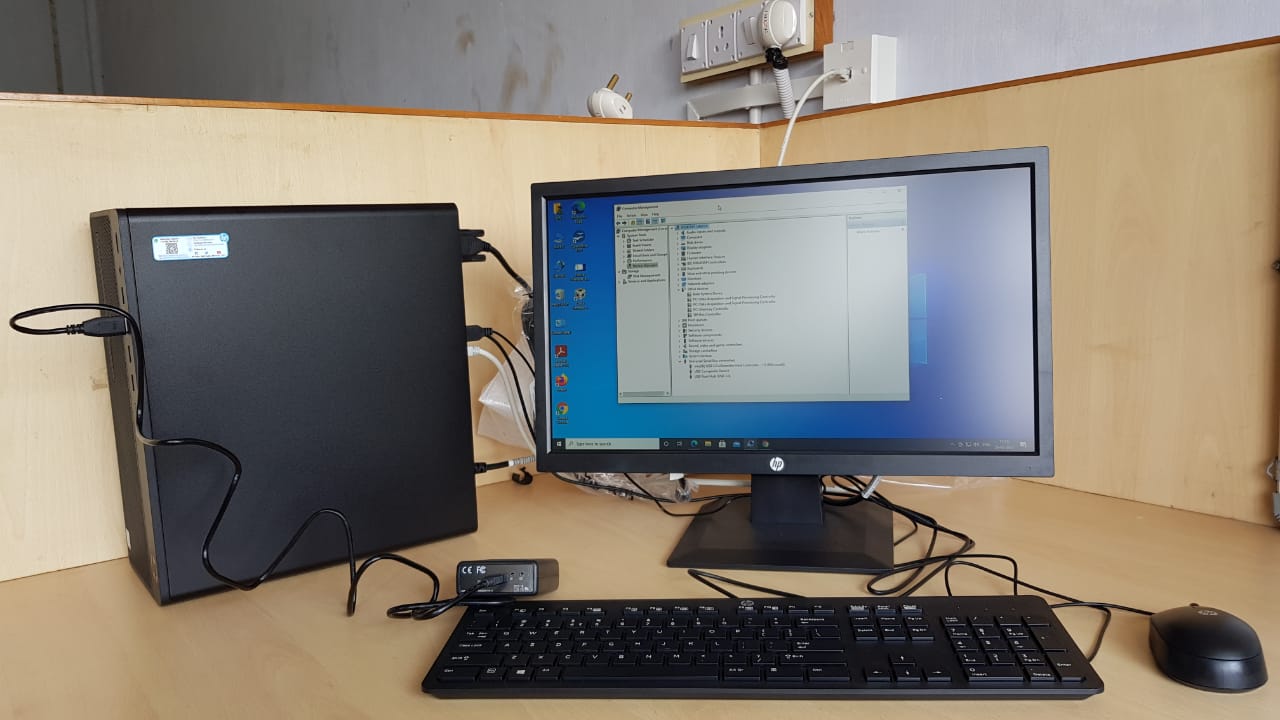

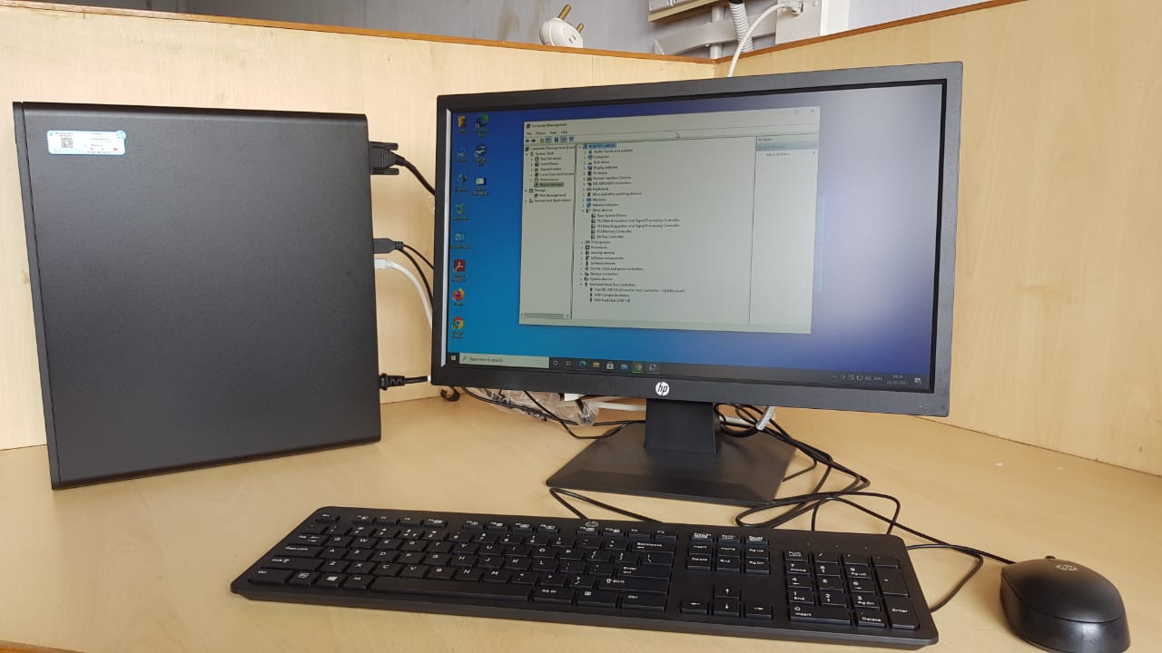

    I have tried connecting XDS110 to 3 different desktops with the following programs loaded:
    Desktop 1: New PC. CCS/ Matlab/RT LAB  is not installed.
    Desktop 2 (With the following software's installed) : Matlab 2016b, Matlab 2017b, CCSv 7.1.0, RT-Lab 2020.4
    Desktop 3 (With the following software's installed) : Matlab 2016b, Matlab 2019b, CCSv 8, RT-Lab 2019
    In all the three desktops, the D1 LED on the XDS 110 glows but there is no bus activity.
    Request your support in this regard.
    Thank you.

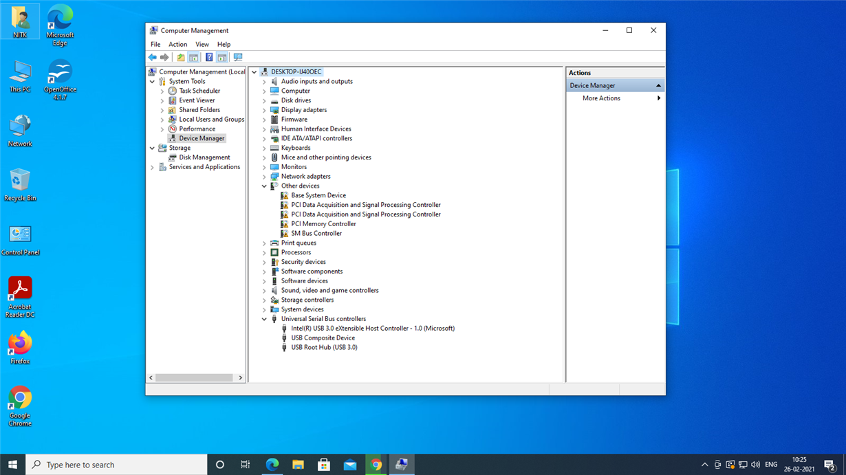

  • Thank you for the reply.
    I have referred to the installation instructions for CCSv9.0.0 at https://software-dl.ti.com/ccs/esd/documents/ccs_downloads.html and installed the same on a new desktop PC with Windows 10 Pro 64bit OS.
    Desktop PC before installing CCSv9.0.0 (PC is connected to 1 USB Mouse+ 1 USB Keyboard+ 1Ethernet LAN)
    Device Manager before installing CCSv9.0.0
    XDS-110 Connected to PC after Installating CCSv9.0.0
    Screen shot after executing the command xdsdfu -e in command window.
    The D1 LED on the XDS110 device glows but the device is not detected by the PC. Since the Device manager and the xdsdfu -e command did not show any device connected, I could not go ahead with the troubleshooting.
    Request you support in this regard.
    Thank you
    James

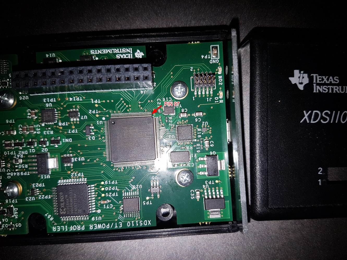

  • Hi James,
    Unfortunately it looks like your XDS110 probe is bricked. I'm not sure how that happened but based on the information you have given, it appears to be the case. You can try to fix it but the fix is a pain on the standalone probes. The procedure is described in the below document that comes with CCS:
    <CCS INSTALL DIR>\ccs\ccs_base\common\uscif\xds110\XDS110SupportReadMe.pdf
    See the last section "Recovering a Bricked XDS110 without JTAG"
    When looking at the TM4C1294NCPDT datasheet: https://www.ti.com/lit/ds/symlink/tm4c1294ncpdt.pdf
    Page 1771 shows the pin out for the TM4C1294NCPDT. Based on that, it looks like pin 97 is as shown below on the probe:
    You try the the steps in the readme to unbrick it. I have a probe in a similar state that I need to unbrick also (which I will attempt in next few days).
    ki
    And looking at the picture, pin 97 on the TM4C1294NCPDT is connected to J1 pin 6. It might be easier to ground J1 pin 6.
    Also, J1 appears to be an ARM 10-Pin JTAG connector. Not sure if that allows the TM4C1294NCPDT in the XDS110 to be unbricked by a different probe.
    Yes that is a good point
    I actually tried attaching a debug probe to that header to see if I can establish a debug session with CCS to erase the flash. But I wasn't able to connect to the TM4C. There likely is a step I am missing to get that going but I'm not sure what it is. I've actually never tried unbricking a standalone probe.

  • Thanks Ralph. I'm pretty sure that is a 10-pin JTAG header for the TM4C that Chester pointed out. But I get an error about no target power when trying to connect with the debugger. When I physically connect my other debug probe to the JTAG header, I see the D2 led go off. I am likely missing some step but not sure what it is. Would you by chance know how to set this up for the TM4C on a standalone XDS110?
  • Hi Ki,
    Unfortunately I do not, I've never cracked one open before and only kind of realized in hindsight of this post that of course there is a TM4C inside since we use it for the LaunchPad emulators. Is the no target power showing up for the unlock sequence? I'm not familiar with the setup or schematic but presumably the JTAG is used for first time programming over boot loader so I would think that power shouldn't be an issue if nothing else is connected.
    I would be surprised if this is the case but... check the TDO pin if it is toggling at a constant frequency. If the TDO toggle occurs with a fixed frequency then that indicates that something has gone wrong during the process of boot up of the device, and that would mean the device cannot be recovered and must be replaced.
  • It's alive!
    Thanks for sharing that document Ralph. It mentions to use an XDS100v2 or XDS200 to unbrick it. I was originally using another XDS110. I then switched to an XDS200 and was able to connect to the TM4C via UniFlash and flash the boot_loader.bin file at address 0x0 and that did the trick and set my XDS110 in DFU mode so that I was able to then flash the xds110 firmware successfully! My XDS110 probe is now successfully unbricked! Thanks!
    James - I'm not sure if you have an XDS100v2 or XDS200 with the necessary adapters to connect to the 10-pin JTAG header on the XDS110 probe. If so, then you can unbrick it using UniFlash. If not, then you'll have to go through the more arduous way I mentioned earlier.
    ki
