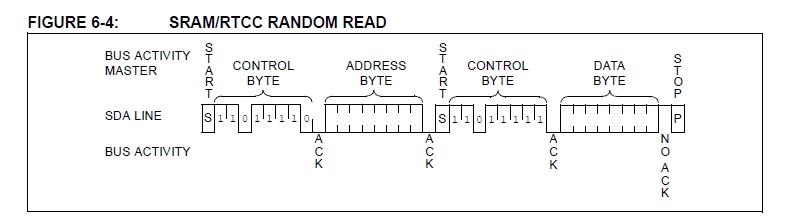

  • Many thanks for the reply, I'm no I2C expert and limited experience with this bus. Yes it looks like it should support repeated start condition. I'm confused how to do a simple register read from the RTC clock chip and new to the RTC part also. I'm trying to do a single register read from a MCP79410 part to check the running status.
    I'm attempting to write the command byte and read a byte back. I don't understand if there's a stop/start condition between writing the read register command and reading back the result byte. It seems like the part wants a repeated start between the write/read operation. The driver interrupt is giving an error in the section below.

  • This is what the RTC chip wants to see with repeated start condition.
    I'm not sure how to achieve this with the I2C driver I2C_Transaction API. Is this even possible through I2C driver interface? Seems like a special flag would be needed somewhere to tell it not to send the STOP condition after writing the control byte and address. It appears to me this is not even possible through TI-RTOS I2C API?

  • What you want is to do a single call to I2C_transfer with a write count of 1 and a read count of 1. You need to set the slave address using only 7 bits. The last read/write bit is added by the driver. For example an RTCC address of 0x6F instead of 0xDE and 0xDF.
  • Hi Bob,
    Many, many thanks!! Finally have this annoying part working! My goof, I changed my address macros per below.
    #define RTCC_WRITE (0xDE >> 1) // DEVICE ADDR for RTCC MCHP (writes)
    #define RTCC_READ (0xDF >> 1) // DEVICE ADDR for RTCC MCHP (reads)
    Originally, I had the code writing and reading one byte, but couldn't understand why it wasn't working.
    I had forgotten all about the addressing bit shift issue due to my own oversight. Thanks so much for your help!
