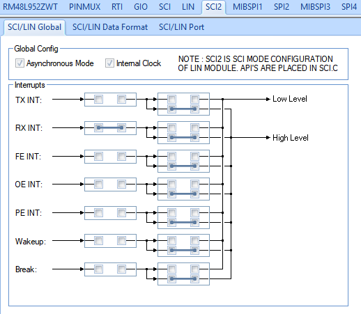

Hello Expert,

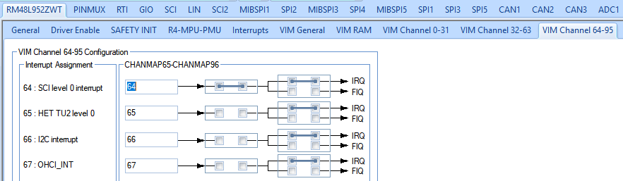

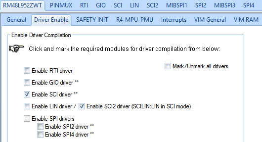

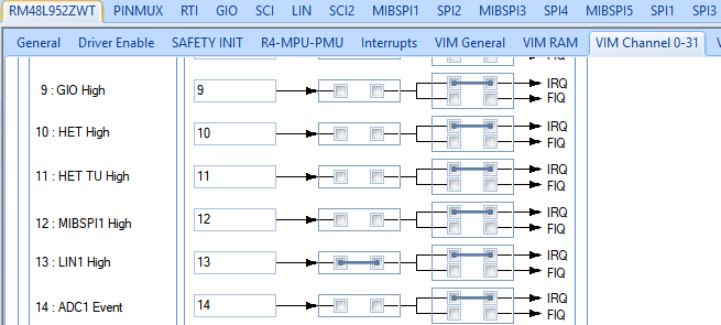

I am working on RM48L952ZWT board. This board has 2 SCI one as normal SCI1 and other as SCI2 which can be used as LIN. I am sending my data from the SCI2 (using it as SCI) and receiving it on SCI1. The configuration on halogen is shown below:
On the hardware I have connected the both SCI using wires and my code is below:
