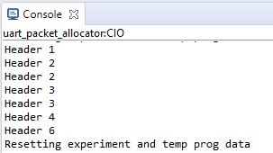

I am writing a uart driver code for TM4C1294XL using TI RTOS for TIVA C version 2.16.0.08. I have attached .c file.
The goal is to segregate the UART packet based on the packet header and store it in a particular variable.
As I am new to TI RTOS, I referred the 'uartecho.c' and made the changes accordingly.
However, sometimes I see that the packets are corrupted.
Can anyone suggest any ideas on how to debug this issue?
Thank you
Shaunak

  • Hey Ralph,
    I have attached two images.
    This image shows accurate parsing of incoming UART packet
    Whereas, in the following image you can see corrupted packet
    The data for some reason takes value of 2^24/2^25.
    Looking at those values in hex suggests 3 bytes have got dropped somewhere, and the 4 byte packet_header then gets 'offset' to the actual stream.
    I haven't yet looked at your code, but a previous investigation into the TI-RTOS to TivaC UART driver found if receive errors occur the receive characters with the errors are not placed in the ring buffer and UART_read() doesn't return UART_ERROR. See TM4C129ENCPDT: Issue with UART_read(). Perhaps you could try setting a breakpoint on the errorCallback() function shown in the referenced thread to see if receive errors are occurring.
  • Hello Shaunak,
    I agree with Chester's thoughts here as well. Reviewing your code I noticed that you do not check the return value for UART_read to verify the data is valid after the initial check to read the size. Though I hadn't heard yet that there is an issue with the UART_read return. My understanding, and correct me if I am wrong Chester, is that UART_read will sometimes fail to return UART_ERROR under specific conditions. If so, I believe it would still be useful to check first to see if there are errors occurring before trying to workaround the issue with the UART_read.
  • It looks to me like UART_read() will return the number of characters that are in the buffer. If you don't want it to return until you get all of the characters requested, you should call UART_readPolling().
  • Sure, will try this and update here.
