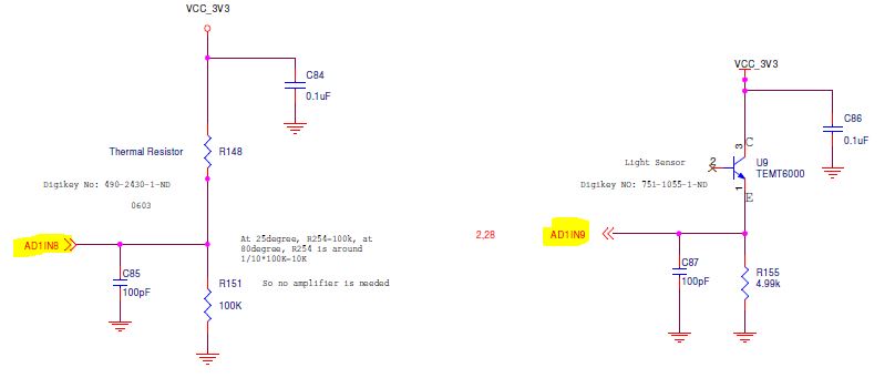

RM48L952: On board temperature and light sensor pin connection
Part Number: RM48L952
I have seen in the RM48 Hercules Development Kit (HDK) User Guide that the RM48L952 has one temperature sensor and one light sensor, but am unable to find which ADC pin is connected to the sensors. I have to read the values from the sensors using I2C.
