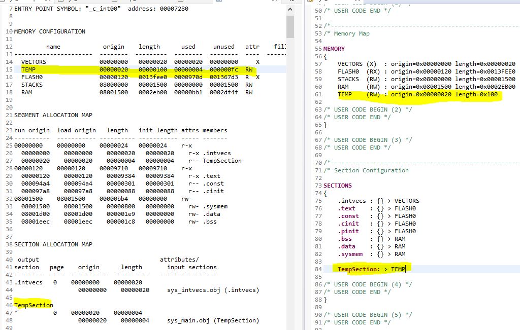

We are using CCS  Version: 10.1.1.00004  and  ARM compiler TIv20.2.4LTS. when building the project (optimization is disabled) it fails to create memory for const data.
Example :
file.c
#pragma DATA_SECTION (Temp,"TempSection");
const UINT32 Temp  = 0x98989898;
file.cmd
MEMORY
                 TEMP          : origin = 0x0000FF00, length = 0x0100
SECTIONS
 TempSection: > TEMP

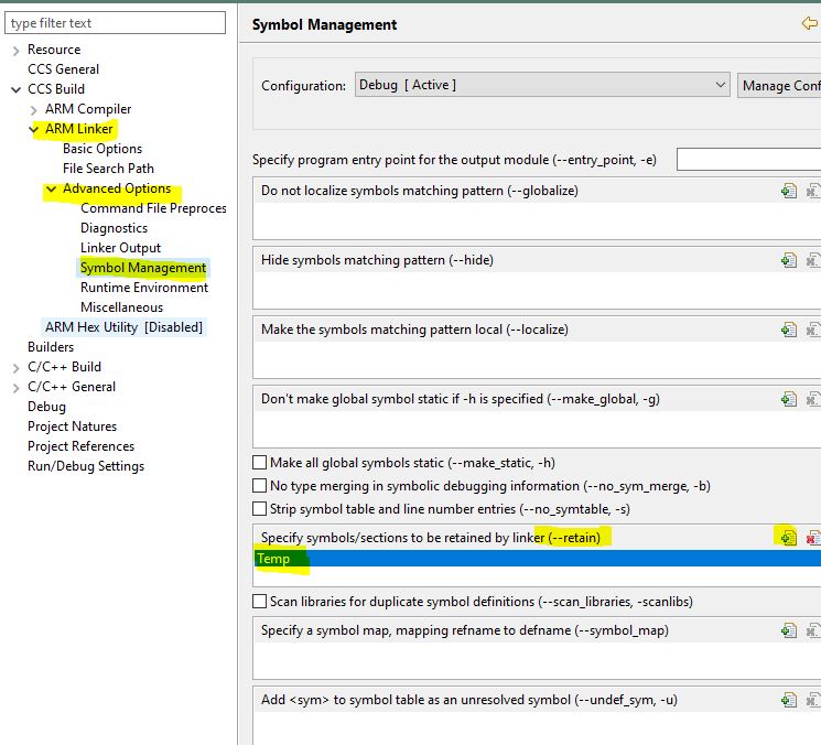

The project is build successfully and .out file is generated, however  memory is not generated for "Temp " in map file. As per map file it is showing used memory as "0x0" instead of 0x4. Please let us know how to resolve this issue.
map file:
name        origin     length            used           unused          attr fill
TEMP   0000ff00   00000100     00000000    00000100      RWIX
