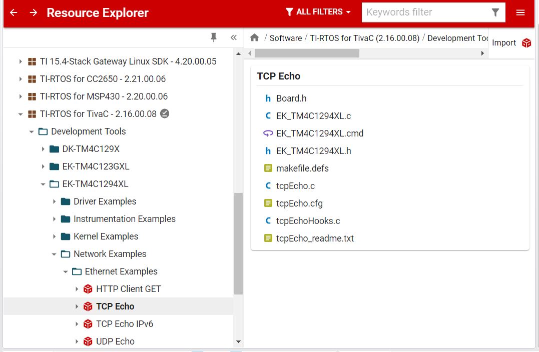

  • HI Robert,
      Do you remember what changes you made that caused it to not work anymore? Can you import the TI-RTOS Ethernet example such as tcp_echo. This example will use the DHCP to acquire the IP address. See below and let me know if you still have problem. The example is proven so it should work. If the example works then you can compare the .cfg file with your modified .cfg file and hopefully you can find some subtle differences that may explain the reason of the problem. By running the example,  I want to know if it is a software problem or hardware problem.
