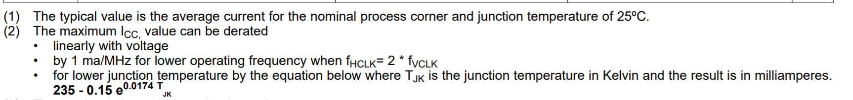

I am aware that the TMS570LS3137-EP datasheet mentions the power consumption of the device under normal operation conditions in Section 5.5, as shown below,
However, I am unable to get information on power consumption if the device is held in reset, say, power reset or logic reset.
Is any application note available for this ?
