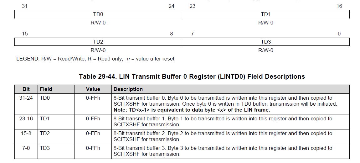

    since the architecture of Buffer registers, the data should be swizzled. The current example code copies buffer[0] to TD3 and buffer[1] to TD2.
    char Buffer[0] should be written to TD0, buffer[1] to TD1,...

  • Hello Rakesh,
    Did you test using the swizzled data? I don't think the DMA setting can swap the buffers. You need to find a way to swizzle the data in memory manually.
