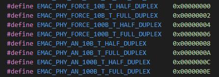

    • The PHY is configured in the function EMACPHYConfigSet:
    • This function is called from EMACMSP432E4_emacStart in EMACMSP432E4.c

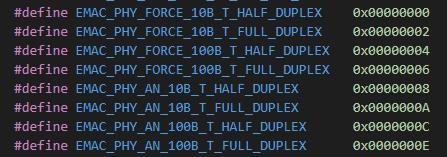

    • These are some of the options for config parameter:
    • By default, the TI Drivers are using EMAC_PHY_CONFIG (shown above) which is defined as 100M with auto-negotiation in EMACMSP432E4.c as:
    • While that is not a parameter that can be reconfigured using TI Drivers, the function is called from a library.

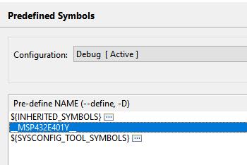

    • As such, we can simply override the file by adding EMACMSP432E4.c (from ~SDK\source\ti\drivers\emac) to the project and modify it manually:
    • After adding that source file to the project it is necessary to pre-define __MSP432E401Y__ to build the file. You can add this in the project build options like this:
    • Building the project and examining the map file shows that the linker now calls the function directly from the .c file, not the library:
