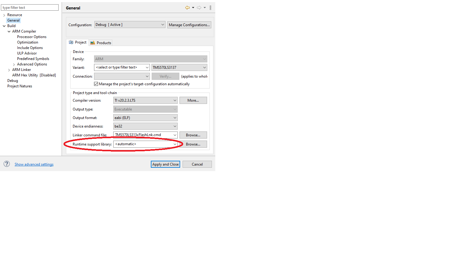

  • I presume you use Code Composer Studio (CCS) to organize and build your project.  In that case, be sure that in the project properties, you set the Runtime support library to automatic.  Under that setting, the linker automatically determines that a  RTS library with exception handling is required.  Since that library is not supplied with the compiler, it is automatically built.
    The screen shot below shows the related CCS setting.
    Thanks and regards,
    -George
