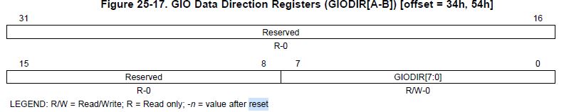

    The TRM register description includes the bit-field reset values. This typically refers to warm reset (system reset nRST). For example, the default value in GIO DIR register shows that the GIO pins is configured as INPUT after RESET (warm reset).

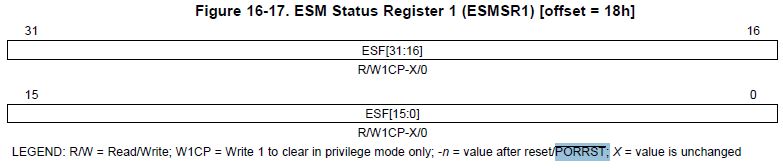

    Any bit-field that is only reset by cold reset (power-on-reset nPORRST) is explicitly specified as such. For example, ESM status registers are only reset by cold reset.
