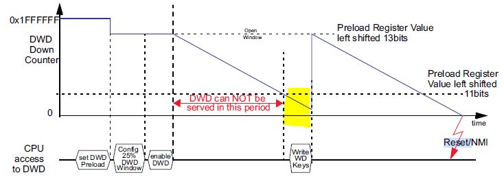

I have a query related to Windowed watch.
In Normal watchdog mode whenever assign wrong sequence or not assign correct sequence within the timeout (preload) processor will get Reset.
In windowed mode, assigning wrong sequence within window size timeout, should not take input and should not reset.
in my case it is resetting.
Do i want consider anything in this regards.
or how to test this
or is my understanding wrong?
