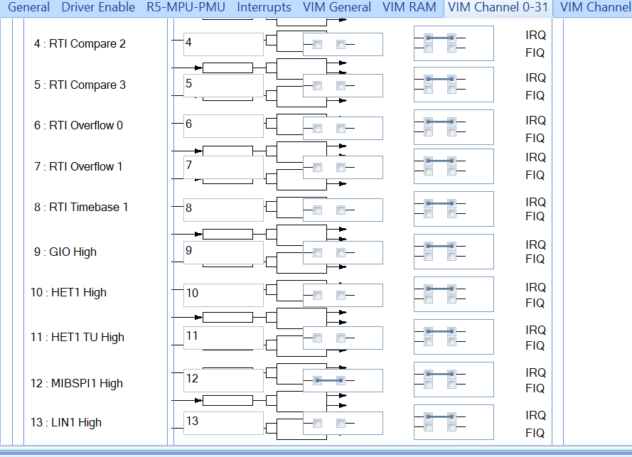

Also I have Enable the MIBSPIx interrupt in the MIBSPIx VIM tab and mibspiEnableGroupNotification and enable the IRQ,
but still there is no data is getting received in  RXDATA,

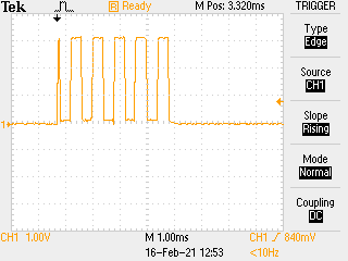

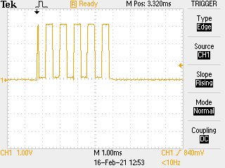

Then i have removed the loopback mode and check the clock pin on DSO and observed only 6 clocks is generating,

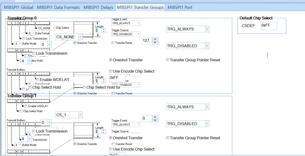

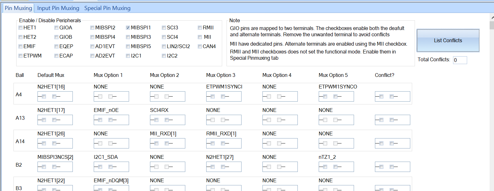

 The Halcogen settings are:
Please let me know what i am missing,

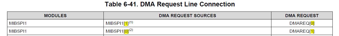

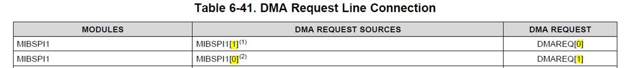

    You need to enable MibSPI DMA for transmit and receive, and map the DMA request line to MibSPI DMA channel.
    1. Enable DMA TX: Bit 14 (TXDMAENAx) of DMAxCTRL register
    2. Enable DMA RX: Bit 15 (RXDMAENAx) of DMAxCTRL register
    3. Map DMA request line: RXDMA_MAPxand TXDMA_MAPx of DMAxCTRL register
    You can use mibspiDmaConfig() to enable DMA and map the request lines.
    In your code: you map DMA channel 0 (RX) to DMA request 1,and DMA channel 1 (TX) to DMA request 0, so please call mibspiDmaConfig() as:
    mibspiDmaConfig(mibspiREG1,0,1,0); where 1 is [1] of MIBSPI1[1] whose DMA REQUEST is used for TX, 0 is [0] of MIBSPI1[0] which is used for RX.
