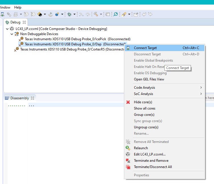

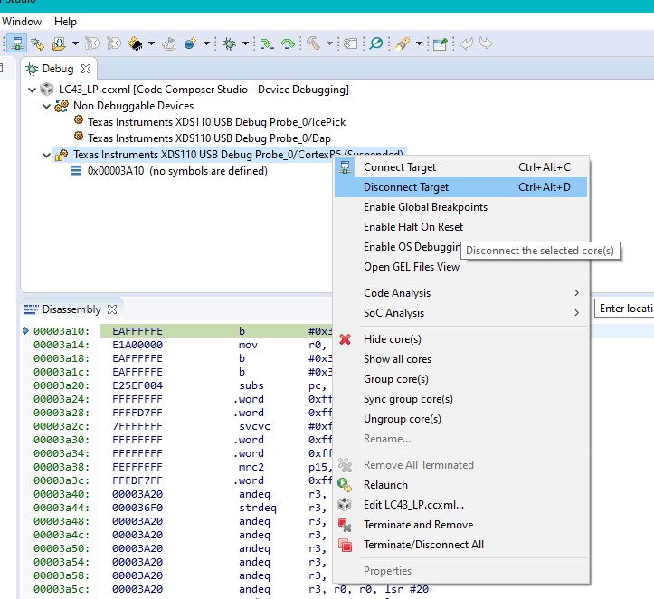

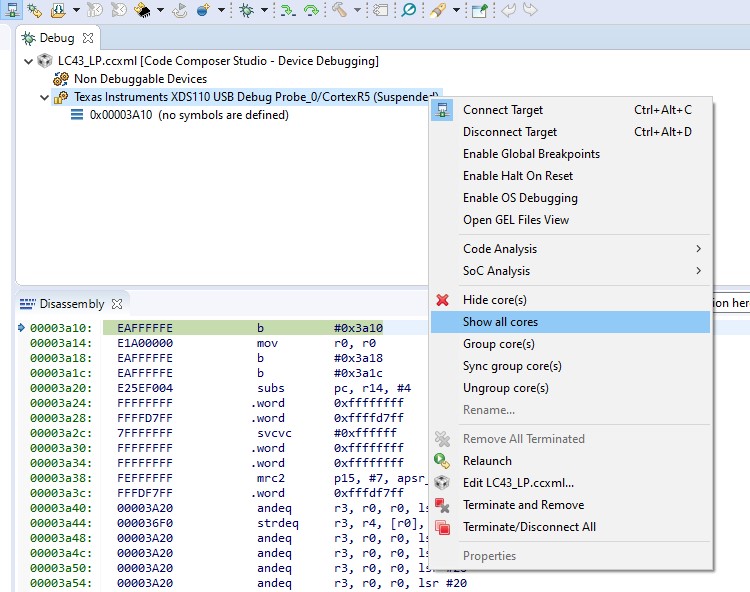

  • QJ, Pratik,
    There is also a simpler way of accessing the on-chip RAM without affecting CPU code execution. The debug sub-system on TMS570 devices includes a Debug Access Port (DAP) that can be used to read/write from/to any memory location.
    Follow the sequence in the below images (done on a TMS570LC4357 LaunchPad):
    This does require you to first connect to the CPU (thereby halting it) since it is the default core to be connected to (defined via the .ccxml file). This can probably also be changed to connect to the DAP by default, so you don't have to halt the code execution at all.
    After the last step in the sequence, you are using the DAP interface for the memory accesses while the main application code continues to be executed by the CPU.
