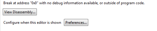

We are using TMS570ls3137 and CCS10.2 (compiler version is TIv20.2.4.LTS) in our project , the project is build without any issues and .out has been generated successfully, however when I wanted to debug the code it is showing "Break at address "0x0" with no debug information available, or outside of program code." after flashing code. I'm able to see my code  and program control at Disassembly window not in the source file. Could you please tell us how to resolve this issue?
I have attached snapshot for your reference.

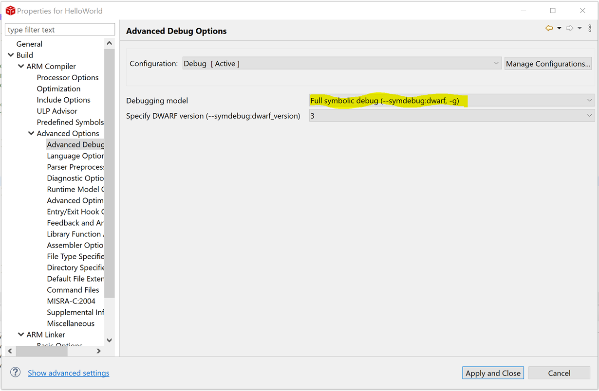

  • With the default settings you should not have had a problem. Right click on your project in "Project Explorer" and select "Show Build Settings". Then select "Build", "Arm Compiler", "Advanced Options" , "Advanced Debug Options" and make sure that "Debugging model is set to "Full Symbolic debug". See below:
    If that does not work, try loading the attached simple project into your part and running it:

  • Hi Bob,
    I have loaded the attached sample project and it is flashed, however program doesn't enter into debug mode. In disassembly window it is showing "No debug context". Could you tell me how to resolve this issue?

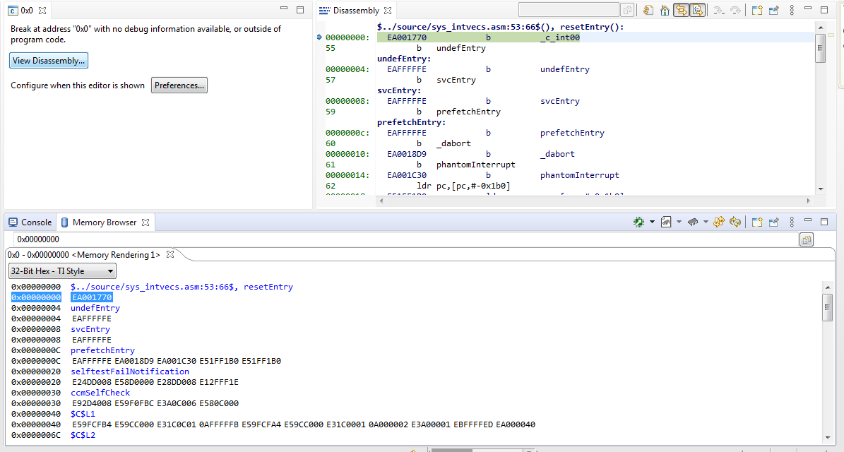

  • Please verify that you loaded the code from "HelloWorld\Debug\HelloWorld.out" without recompiling the file. When loaded the code should run to main and look like this:
    Since yours does not, please open a memory window and verify the flash contents starting at address 0: It should look this. If not, you did not load the file correctly.

  • I have flashed the code as per the suggestion, still I got the same issue, I have attached snaps (captured memory , disassembly , and source code) for your reference, I just wanted to understand why it is showing no debug information at 0x0. The memory window data is inline with your attachment.

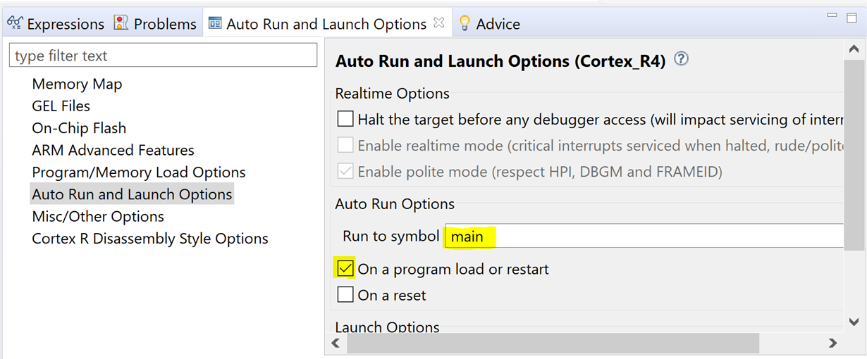

  • It looks like one of the default settings was changed in your CCS settings and the code is not automatically running to main. You can do an assembly step by clicking the small green arrow, or choosing "Run" -> "Assembly Step Into". Then you will execute the reset vector and jump into the C function _c_int00(). If you want to restore the ability to run to main on a program load, select "Tools" -> "ARM Advanced Features". Then select the "Auto Run and Launch Options" as shown in the image below. Enable "Run to symbol" "main" and check "On a program load or restart".
