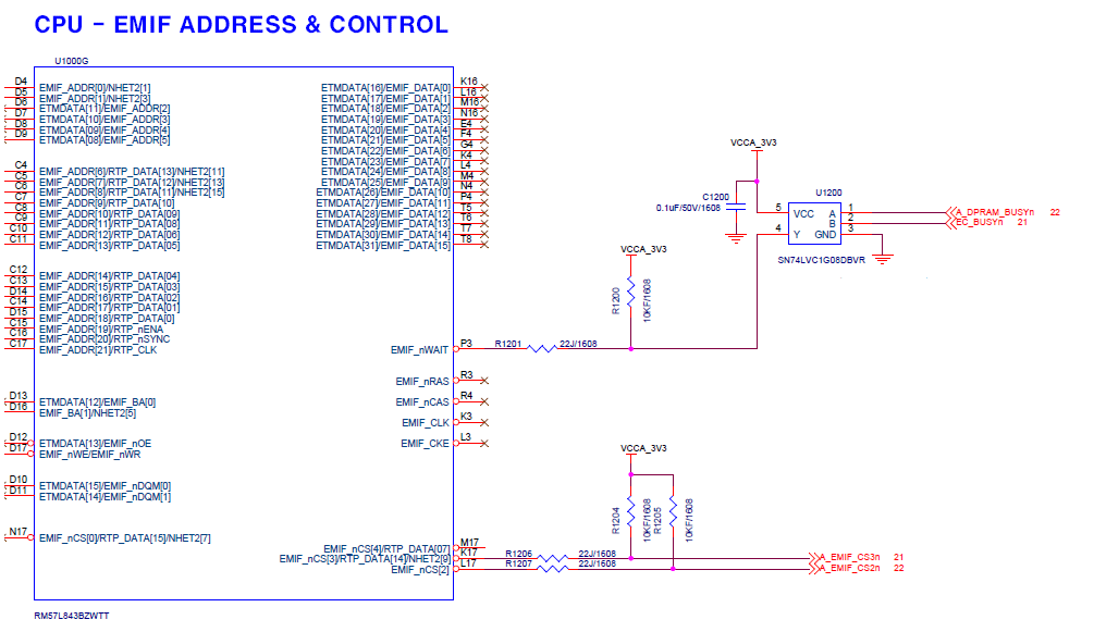

I connected two devices to the EMIF_nWAIT pin of EMIF.
The EMIF_nWAIT pin is connected to the busy pins of DPRAM and ET1100.
Can the EMIF_nWAIT be used as GPIO while ET1100 is enabled? (DPRAM is disabled)
If the pin is busy when executing the write command, I want to stop the write attempt.
I want to manually control the write attempt.
Is this possible?

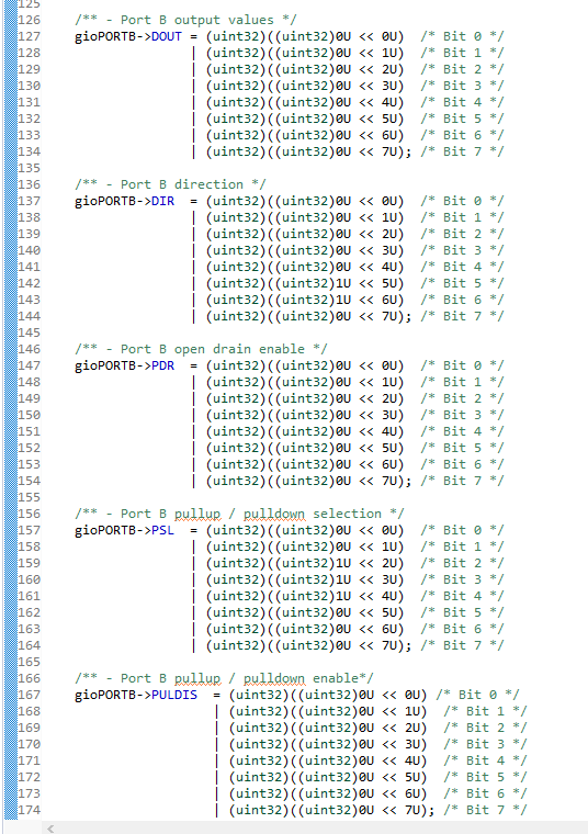

    I configured P3 pin as EMIF_nWait  and GIOB_7.
    The GIOB_7 is also mapped to the GPIO interrupt.
    When the EMIF_nWait is asserted, GPIO interrupt is occurred.
    My question is whether the EMIF_nWait pin can be used simultaneously with the GPIO function.
    In my test, it seemed possible.

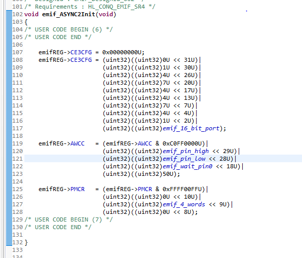

    The external wait cycles is determined by nWAIT input signal. If nWAIT is asserted, the EMIF begins inserting extra strobe cycle into the operation until the nWAIT pin is deactivated by the external device. But the nWAIT pin cannot be used to extend the strobe period indefinitely. The maximum number of EMIF Clock cycles (1~0xFF+1) is defined in AWCC register
    If it exceeds the maximum clock defined in AWCC, what is the next action?
    Does it keep trying to write? or does it stop trying to write?
    I want the write attempt to stop when counter is expired.
  • Hi SY,
    P3 in can be used as either nWAIT or GIOB[7]. It cannot be used for both at a time.
    There are two terminals for GIOB[7] input: F1 and P3. T1 is selected by default. If you change it to P3, PINMMR87[17:16] needs to be programmed (10b or 0x2).
    If the EMIF_nWAIT pin is not deactivated within the time specified in AWCC, the EMIF resumes the access cycle, registering whatever data is on the bus and proceeding to the hold period of the access cycle. This situation is referred to as an Asynchronous Timeout which will generate an Asynchronous Timeout interrupt if the interrupt is enabled (INTMSKSET).
