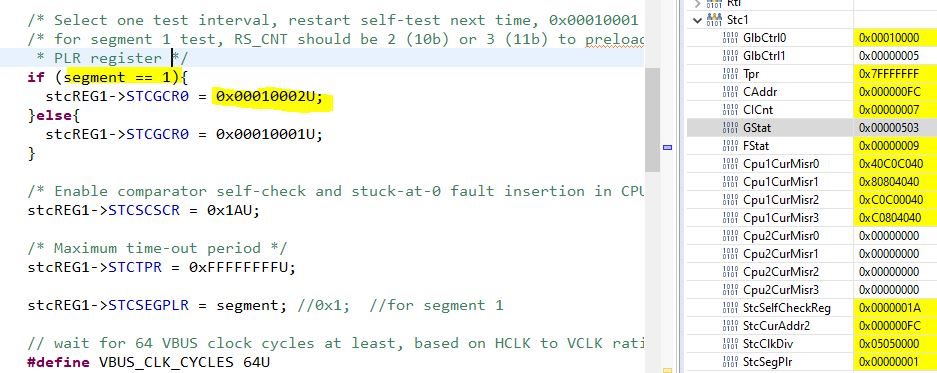

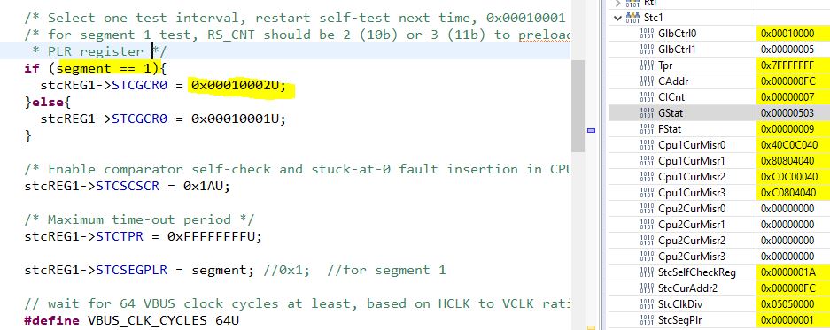

  • Hello Dhana,
    I redid the test and noticed that the FSEG_ID is 0 even the failure is caused by segment 1 selftest. I doubt it is a literature bug.
  • Hi Wang,
    Thank you for helping out. Is the literature bug in TRM related to RS_CNT bits (0x2 instead of 0x1) or anything else. Could you please confirm.
  • Hello Dhana,
    You are absolutely correct. Writing 1x (10b or 11b) to RS_CNT is to preload interval from STCSEGPLR register.
    I will submit a literature bug ticket to fix the problem in TRM. Thanks for pointing this out.
  • This is my test: the FSEG_ID is 1 (segment 1 failed)
