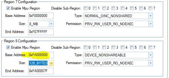

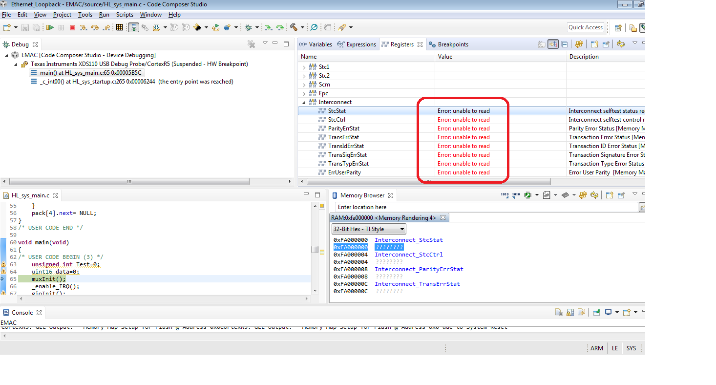

As per the attached screenshot, I am getting the error during the debug mode option. I am able to read the other registers.
I am getting this problem due to debug mode memory map GEL file. Please find the corresponding GEL file link mentioned below,
C:\ti\ccsv8\ccs_base\emulation\gel\rm57l8xx.gel
    /* SDC MMR Port */
    GEL_MapAdd(0xFA000000, 0, 0x00000100, 1, 1); /* SDC MMR Port              */
What will be the value needs to updated ? (or) Do I need to update the some other register?
