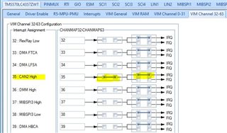

    I need a support on the CAN Rx Interrupt method, I have created the CAN TX in CAN1 and CAN RX in CAN2
    CAN2 : node is always not equal to the canREG2
    /* node 2 - receive complete */
    if(node==canREG2)
    while(!canIsRxMessageArrived(canREG2, canMESSAGE_BOX1));
    canGetData(canREG2, canMESSAGE_BOX1, rx_ptr); /* copy to RAM */
    I couldn't receive any data in this above reception CAN ID 0x300.
    CAN1 TX:
    CAN ID is 0x200
    CAN RX:
    CAN ID is 0x300
    CAN Analyzer i sends the data but not hit the breakpoint also. Please check and confirm the CAN interrupt code is correct for TMS570LC4357. with the
    TMDX570LC43HDK.

  • Just read your code, I guess you didn't enable the CAN interrupt in VIM module:
    If low priority is selected in CAN configuration, please enable VIM channel 42
