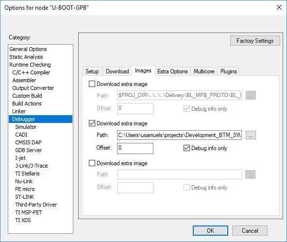

On EWARM, it is possible to load a few extra ELF files, without actually flashing the result.

    On top of that, I want the symbols from another ELF file to be loaded when I start debugging the first file.
    You do not want to flash that ELF file but symbols and source level debugging should be available.

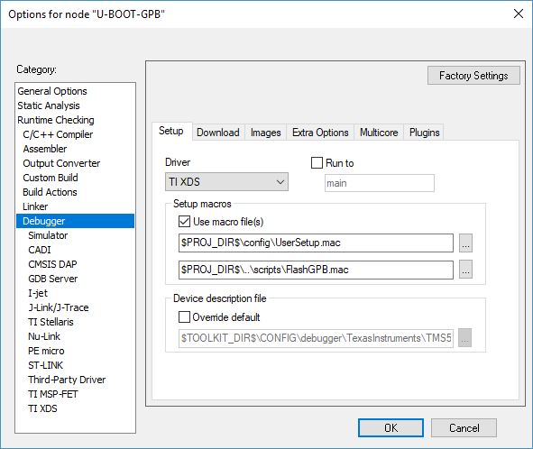

    I enclose the setup for the IAR EWARM to do this.
    Here I just add some Macro files that allows me to fix quirks when loading to SRAM
    I override the IAR standard flashloader with my own which can download to external memory
    I tell C-Spy that I want the symbols for the bootloader.

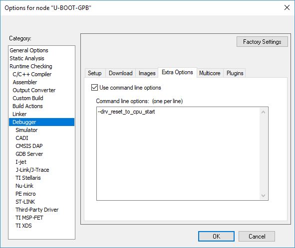

    The application has an ENTRY point in external SRAM. C-Spy will after loading the program and applying reset
    force the program counter to the ENTRY point without running the bootloader. I do not want that,
    so this option does not change the PC, which is forced to 0x00000000 at reset.

    You can load the ELF symbols from your Windows build environment to the CCS Debugger on your Linux machine. That is not an issue. There are two options. One is to use the option to "Load Symbols" (under the "Run -> Load" menu). This will remove any existing symbols already loaded and then load the new symbols. However if you wish to keep any loaded symbols intact, you can use the "Add Symbols" option (under the same menu). This will load the symbols while keeping any existing symbols still loaded.
    If you want to automate the action of loading/adding other symbols when starting a debug session for the first file, you can add this to your GEL startup file, either in StartUp or OnTargetConnect callback functions using GEL_SymbolAdd.
