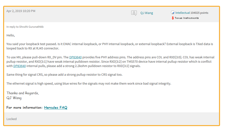

Hi All,
We are using RM57L843 microcontroller. We are not using TMS570 based microcontroller.
 e2e.ti.com/.../785415
    #As mentioned in the above link, Do we need to modify the Launchpad board with below external resistance settings ?
            CRS=2.2K External Pullup resistance with 3.3V.It is available in Launchpad XL2 RM57 board itself.
            RX_ER=2.2K External Pullup resistance with 3.3V.It is available in Launchpad XL2 RM57 board itself.
            RX_DV=2.2K External Pulldown resistance with ground.It is available in Launchpad XL2 RM57 board itself.
            RXD[3]=2.2K External Pulldown resistance with ground
            RXD[2]=2.2K External Pulldown resistance with ground
            RXD[1]=There is no external resistance required
            RXD[0]=There is no external resistance required
            COL=There is no external resistance required
    #There is no Test point (or) Pin out available for RXD[2], RXD[3] in the Launchpad XL2 RM57 board. How do we connect the external resistance?
    #For RM57L843 Microcontroller, inorder to make the Ethernet example program working, Which is the VCLK4 frequency needs to be set? (40MHz (or) 75MHz (or) Both the frequencies OK?)
