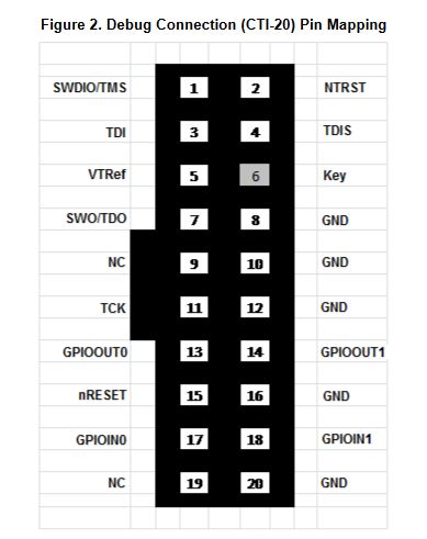

Please tell me if the diagram shows the pins considering the FRC is at the back or FRC at the front side. I want to know the direction of FRC.

Sakthi,
I am not sure what you mean by FRC. Do you mean Flat Ribbon Cable?
Pin 1 is labeled on the XDS110 pod. It is not possible to plug the ribbon cable in the wrong way to the debug probe. The red on the cable marks pin 1.
This document shows the pin assignments for various headers:
http://software-dl.ti.com/ccs/esd/documents/xdsdebugprobes/emu_jtag_connectors.html
When connecting the cable to the header on the board pin 1 should be labeled on the board. I am not sure what board is being used.
That picture you showed from the XDS110 Users Guide is the pin assignment of the debug connection on the back of the XDS110 pod where you connect the cable.
