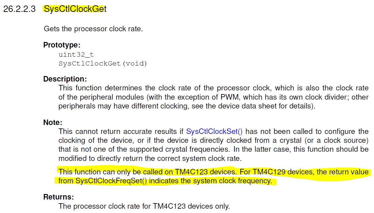

  • I've updated my code to use Tivaware calls in the bootloader. I'm using the same init sequence that I use in my main app (which works) as shown below.
    Everything works up to the point I call ROM_SSIConfigSetExpClk. When I call this function everything hangs. Digging into the Tivaware driver lib code, I don't see anything there that should cause it to hang unless it's stuck in the divide loop. Maybe SysCtlClockGet() is returning bad value. Trying to debug these calls now...
    Bob

  • Hi Robert,
      Glad you are making some progress. I hope this is the reason for the issue. You cannot use SysCtlClockGet() on TM4C129 device. You need to use the return value from SysCtlClockFreqSet() instead for TM4C129 device.
  • Yes, this seems to be the problem. I hard coded the cpu freq and it's now passing the SPI initialization. Now to see if the PetitFS system and flash code works, will let you know. Many thanks again!
    Bob
