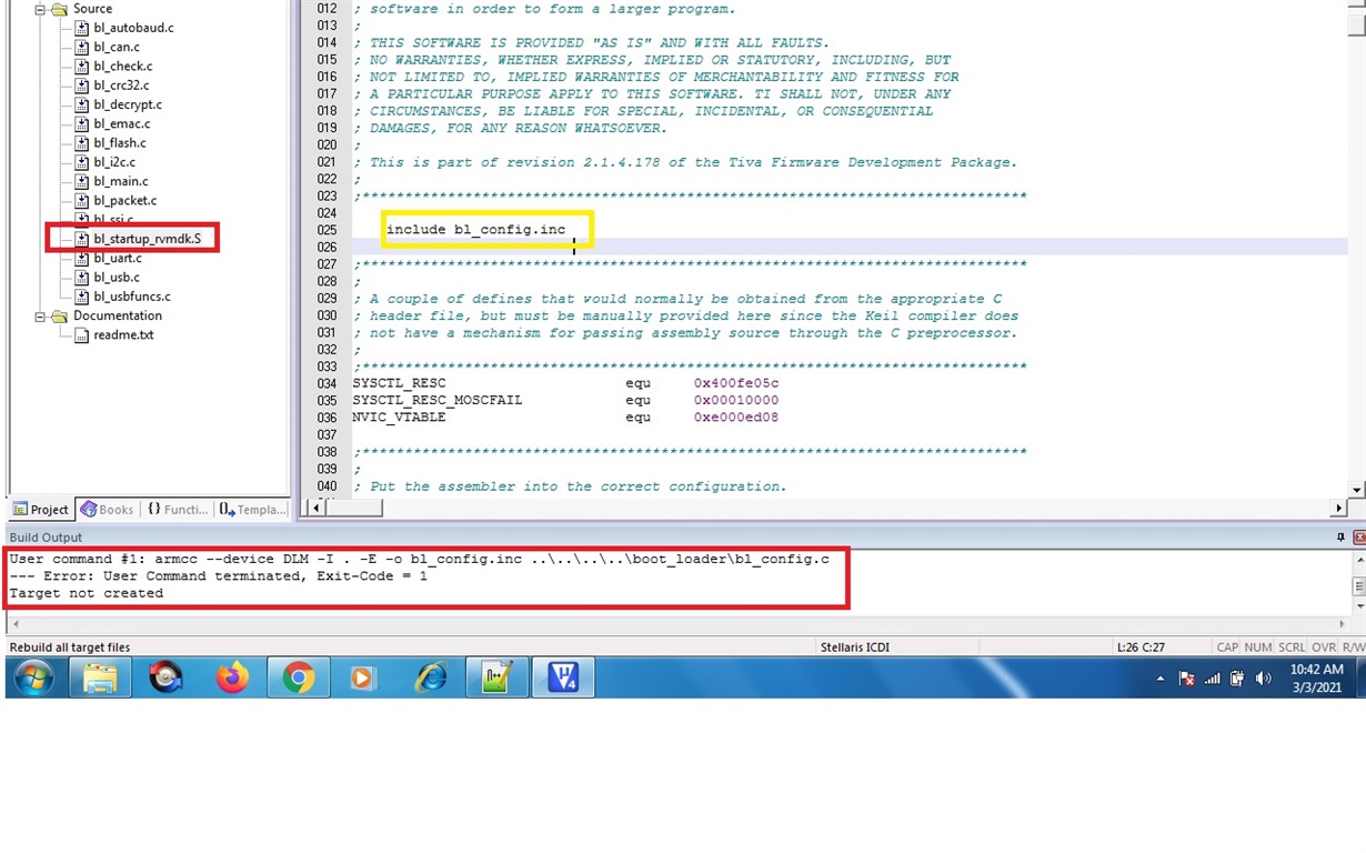

We have started new development using TM4C129x development board. As boot loader guide explain the ROM based and Flash based boot loader but example given for only ROM based.
I want to implement the flash based boot loader using Keil compiler. But not able to compile project.
Compiler is not able to find the include bl_config.inc .
Kindly share the code which compile on keil or supporting file which keil needed.
We are attaching the bl_startup_rvmdk.S file for reference.bl_startup_rvmdk.S

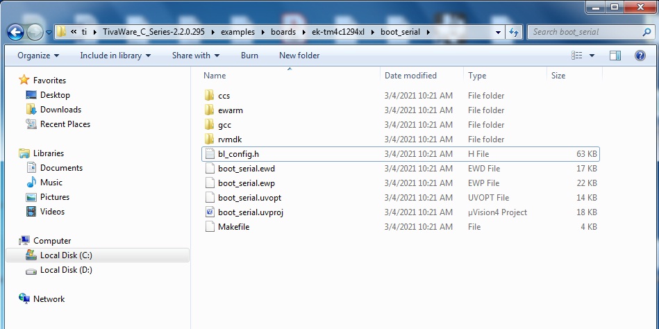

For the CCS, the equivalent startup file is called bl_startup_ccs.s. In it, it includes the header file bl_config.h instead. The bl_config.h is a header file at the application level, not part of the boot_loader library. I think this is why you can't find neither the bl_config.h or bl_config.inc file in C:\ti\TivaWare_C_Series-2.2.0.295\boot_loader.
If you go to the bootlader example like C:\ti\TivaWare_C_Series-2.2.0.295\examples\boards\ek-tm4c1294xl\boot_serial (there are actually a few bootloader examples in TivaWare library), you will find the bl_config.h file. I'm also attaching here for your reference.

c. We are facing issue with compilation in keil compiler using file given(bl_startup_rvmdk.S) in bootloader folder and also not find bl_config.inc .

ABHIJIT KUMAR said:c. We are facing issue with compilation in keil compiler using file given(bl_startup_rvmdk.S) in bootloader folder and also not find bl_config.inc .
As I mention before, can you not copy the bl_config.h from C:\ti\TivaWare_C_Series-2.2.0.295\examples\boards\ek-tm4c1294xl\boot_serial\bl_config.h to C:\ti\TivaWare_C_Series-2.2.0.295\examples\boards\ek-tm4c1294xl\boot_serial\bl_config.inc?

ABHIJIT KUMAR said:2. I have follow your path for bl_config.inc but didn't found the file . There is only bl_config.h file available only
I have mentioned this several times. There is no bl_config.inc in the bootloader example. Please refer to my earlier responses. Can you not just "copy" the bl_config.h to bl_config.inc?

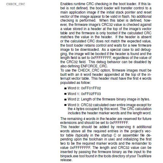

Dear Charles,
I have go through check CRC and given attached link. In the link they have written that you have used startvector bin .
The project startVectors is a simple assembly language project that has the top of stack and start location hardcoded to addresses 0 and 4 for CCS
Sorry, I think I gave you some incorrect information as I was thinking about ROM based bootloader, not flash based bootloading. I said earlier "The bootloader will look at the first two locations of the flash which is the stack pointer at 0x0 and the reset vector at 0x4. If they are non 0xFFFFFFFF value then it thinks the application was programmed. The bootloader will just jump to the application." Please disregard this statement as it applies to the ROM based bootloader.
For flash based bootloader the bootloader will check the first two locations of the vector table of your application. For example, if your application starts at 0x4000 then the bootloader will check the location 0x4000 (the stack pointer) and 0x4004 (reset vector) of the application. The bootloader will reside at 0x0. Please refer to the Bootloader user's guide for detail. Below is an excerpt.
Because the flash boot loader resides at 0x0000.0000, the application must reside in another area
of flash memory. Typically, the application resides in a different flash sector with a different address.
See the device data sheet for specifics about flash sectors for a given device. Contrary to the ROM
boot loader, which checks for the presence of a valid application at address 0x0000.0000, the
flash boot loader checks for the presence of the application firmware at a different address that
is specified to the flash boot loader. The flash boot loader checks if the memory at the first two
locations of the specified address have values that are not equal to 0xFFFF.FFFF. The outcome
of the check determines if the flash boot loader executes the user application or if it loads new
application firmware. The flash boot loader provides the best flexibility to boot load the device.
The TivaWare library provides examples of flash boot loaders to program a device using various
communication ports.
ABHIJIT KUMAR said:Can you not just "copy" the bl_config.h to bl_config.inc?
What I mean by copy is really just copy. It is just to duplicate the file. If you have file called foo.h then you just duplicate another copy of the file with the name foo.inc. I don't know how else to express it. If you want to just rename the bl_config.h to bl_config.inc that is another method. Please try.
