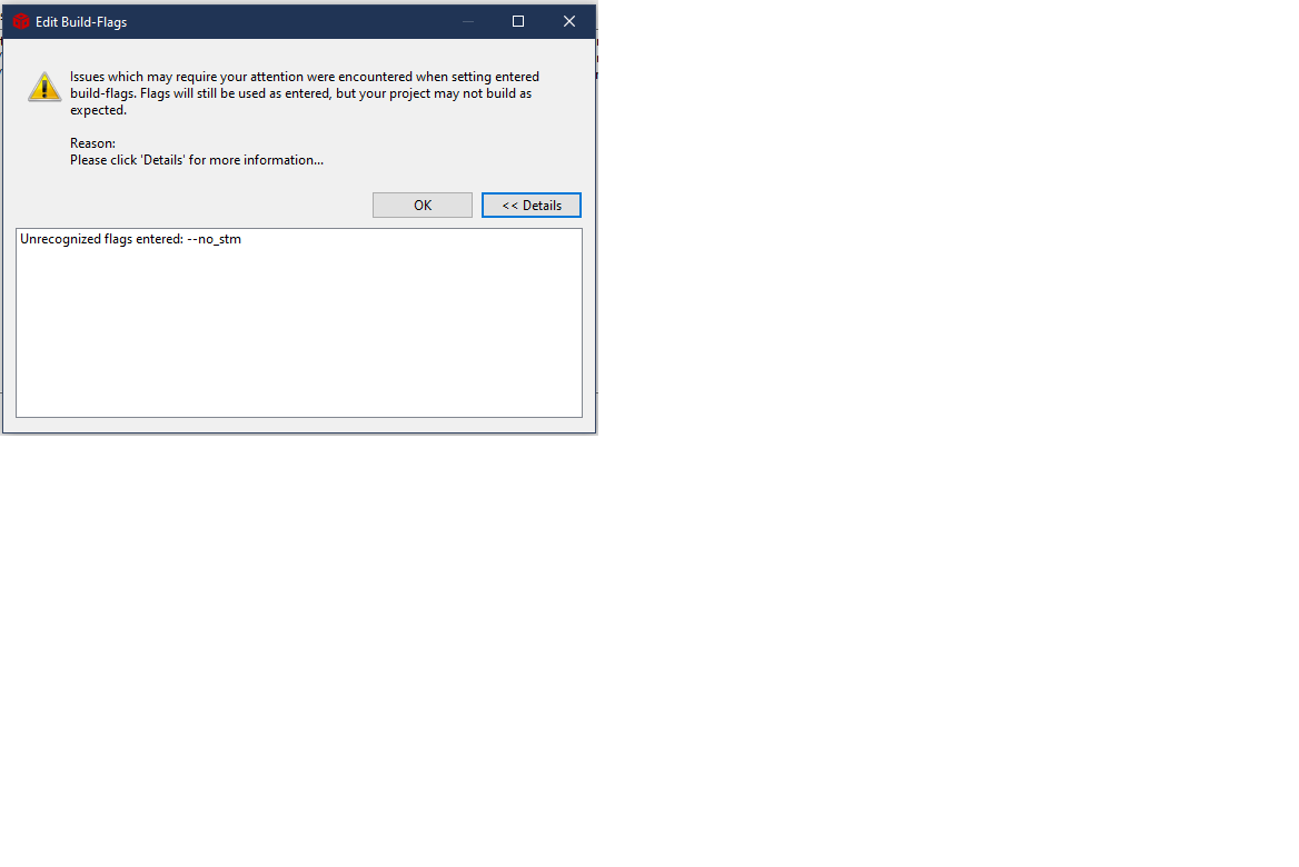

  • Could you please let us know how to apply "--no_stm" option at file level?
  • From within CCS, right-click on the C source file and choose "Show Build Settings", or even "Properties".
    Then you can click on the "ARM Compiler" properties under the "CCS Build" option. Click on the 'Edit Flags" button and type in the "--no_stm" option flag for that specific file.
  • Thank you Sunil,
    When I applied the ARM compiler options at file level I'm getting following annotation from the tool, could you please tell me the reason. I have attached snapshot for your reference. Also did you get chance to discuss with tool team for the first two issues pertained to CCS10.
  • Please ignore the message from CCS. The "--no_stm" flag will still be applied to the compile of this source file.
