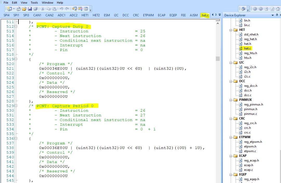

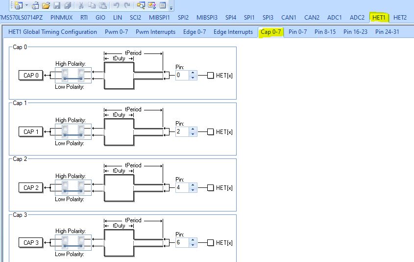

    The N2HET consists of a specialized micromachine that operates a reduced instruction set. The instruction set is listed at the end of N2HET chapter of TRM.
    You can implement timer functions by combining instructions in specific sequences. A simple PWM generator can be implemented with a two instruction sequence: CNT and compare (ECMP or MCMP). A ecap capture function can be implemented using PCNT instruction. You can use either polling mode or interrupt to read the captured data.
    Please read N2HET chapter for details.
    The HALCoGen generates example code for PWM, eCAP, and edge detection:
