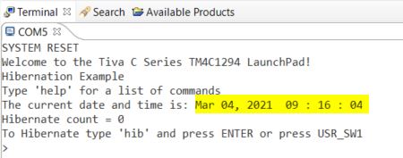

    I manually type in the current Epoch time (1614849342) for North America and I don't see an issue displaying the calendar time on the terminal window. Please see below.

    I have tested it,There will be no problem between 2001 and 2021.but there will be problems with reading before 2000.And there is an identical difference with the actual value.
    I just use it  HibernateCalendarSet(pTime) and HibernateCalendarGet(&sTime);I think these two has bug.
