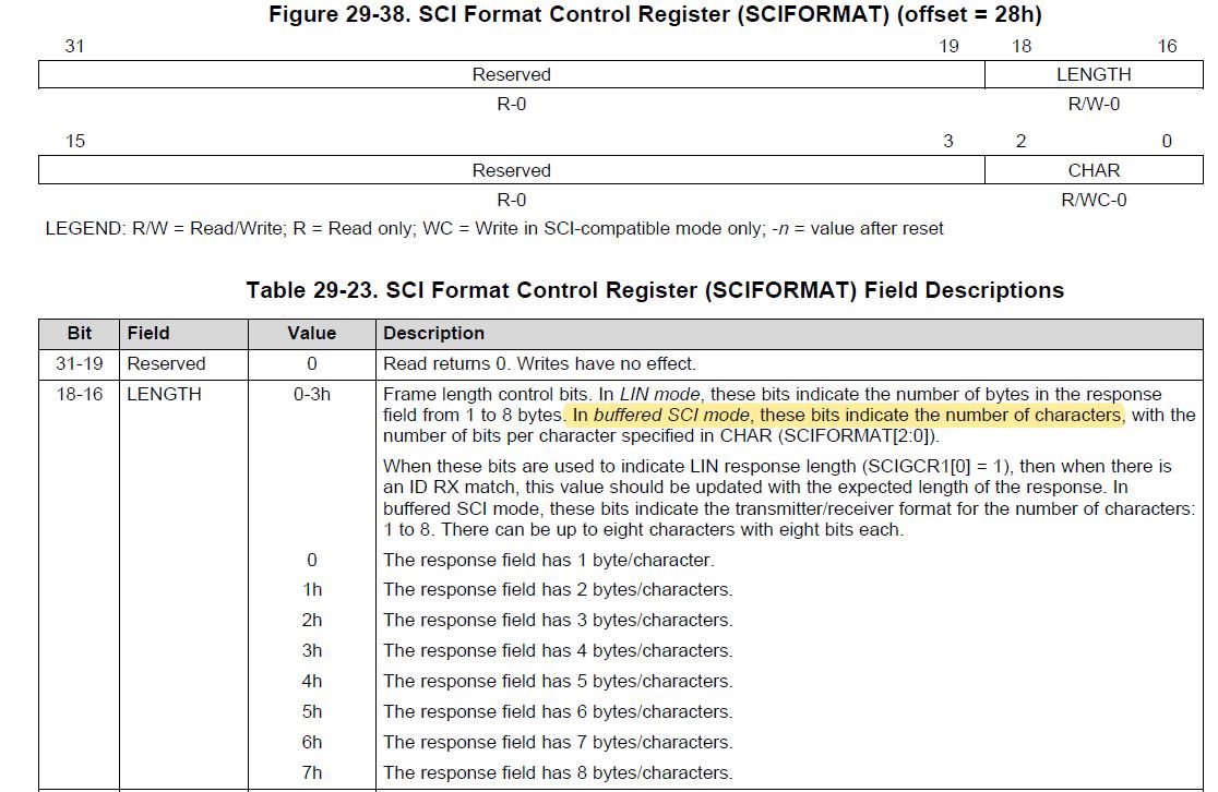

I have a problem using multi-buffered mode on SCI-A/lin.
Basically, I want to generate an interrupt every n bytes in order to not overload the cpu too much.
I thought that with multi-buffered mode I can choose after how many bytes generate an interrupt RXDY but it seems not working.
Here is my code:

To test the peripheral I just send a bunch of dummy bytes and check if ISR is executed (since I'm working in loopback).
Without multi-buffer I can have an interrupt every byte sent and it's working fine, so the interrupts are well configurated but with multi-buffered mode ISR is never executed (I though ISR was executed every 8 bytes trasmitted).
Is it possible to generate an interrupt after n bytes without using DMA? If yes, how to get data? SCIRD register is only 1byte-length and I'm not understanding where the data will be available.

      You should be able to do multi-buffer SCI without using the DMA.
    29.2.1.5 SCI Multi Buffered Mode
    To reduce CPU load when Receiving or Transmitting data in interrupt mode or DMA mode, the SCI/LIN
    module has eight separate Receive and transmit buffers. Multi buffered mode is enabled by setting the
    MBUF MODE bit.
    The multi-buffer 3-bit counter counts the data bytes transferred from the SCIRXSHF register to the RDy
    receive buffers and TDy transmit buffers register to SCITXSHF register. The 3-bit compare register
    contains the number of data bytes expected to be received or transmitted. the LENGTH value in
    SCIFORMAT register indicates the expected length and is used to load the 3-bit compare register.
    A receive interrupt (RX interrupt; see the SCIINTVECT0 and SCIINTVECT1registers), and a receive ready
    RXRDY flag set in SCIFLR register, as well as a DMA request (RXDMA) could occur after receiving a
    response if there are no response receive errors for the frame (such as, there is, frame error, and overrun
    error).
    29.2.4.1.2 Receiving Data in Multi-Buffer Mode
    Multi-Buffer Mode is selected when MBUF MODE bit is 1. In this mode SCI sets the RXRDY bit when
    programmed number of data are received in the receive buffer, the complete frame. The error condition
    detection logic is same as Single Buffer Mode, except that it monitors for the complete frame. Like Single
    Buffer Mode, you can use either Interrupt, DMA or polling method to read the data. The received data has
    to be read from the LINRD0 and LINRD1 register, based on the number of bytes. For LENGTH less than
    or equal to 4, Read to LINRD0 register will clear the “RXRDY” flag. For LENGTH greater than 4, Read to
    LINRD1 register will clear the “RXRDY” flag.
    I think you miss to define the LENGTH which indicates the number of bytes to transfer from the shift register to the receive buffer.
  • Hi Charles,
    In the code that I posted earlier is commented-out but I already done a bunch of tests:
    /** - transmission length */
            sci->FORMAT = 0x0700 | (8U - 1U);  /* length */
    This line makes length = 8 and char = 8, so I'm expecting 8 bytes.

    Another difference I've noticed is that my paragraph 29.2.4.1.2 is slicely different from yours:
    Multi-buffer mode is selected when the MBUF MODE bit in SCIGCR1 is set to 1. In this mode, SCI sets
    the RXRDY bit after receiving the programmed number of data in the receive buffer, the complete frame.
    The error condition detection logic is similar to the single-buffer mode, except that it monitors for the
    complete frame. Like single-buffer mode, you can use the polling, interrupt, or DMA method to read the
    data. The SCI clears the RXRDY bit after the new data in SCIRD has been read.
    I'm using TMS570LC43x 16/32-Bit RISC Flash Microcontroller - Technical Reference Manual" March 2018.
    Where's the issue?
    Thanks for help,
    Marco.

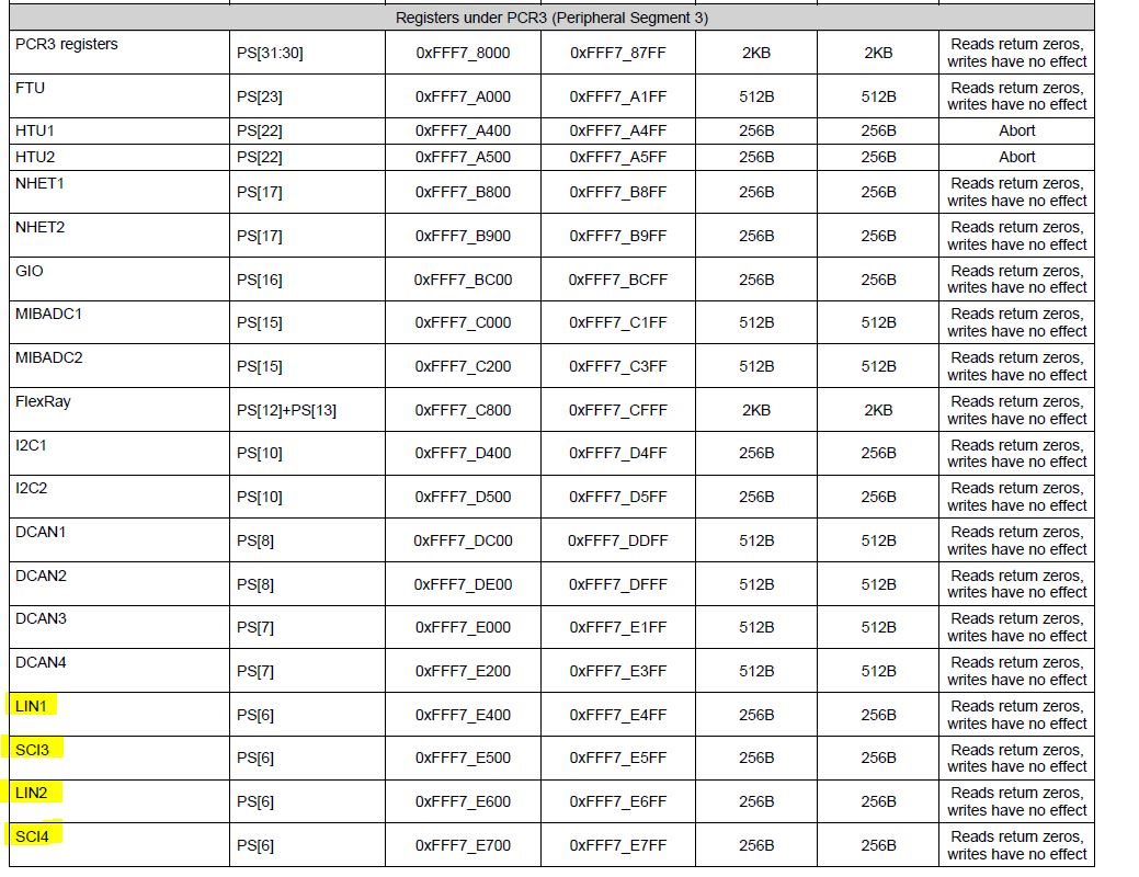

  • Hi Marco,
      I want to be sure if you are using the SCI/LIN module or just the SCI module. Please refer to the below 4 modules in the datasheet. The SCI3 and SCI4 will not have support for Multi-buffer mode. Only the LIN1 and LIN2 in their SCI mode can support Multi-buffer.
    Please also refer to this below post for some clarify.
    https://e2e.ti.com/support/microcontrollers/hercules/f/312/t/928837?tisearch=e2e-sitesearch&keymatch=multi%252520buffer%252520sci
    1
    2
    3
    4
    5
    6
    Sorry, I was using a older release (SPNU56.pdf) of the TRM dated May 2014. Please use what you have which is the latest TRM (SPNU563A.pdf) dated March-2018.
  • Hi Charles,
    thanks for the answer.
    I verified the address of the register and seems ok:
    I checked the link provided by you, and the settings are the same (enable on GR1 + data format).
    Maybe there's an other setting at the CPU level? Maybe anything in VIM? I really don't know..
    /** @def sciREG1
    * @brief Register Frame Pointer
    * This pointer is used by the SCI driver to access the sci1 module registers.
    #define sciREG1 ((sciBASE_t *)0xFFF7E400U)
    P.s. Ok, no problem. I keep using my version of reference manual.
    Thanks for the replies and regards,
    Marco.
