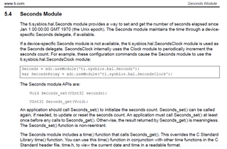

  • The Seconds_set() function is part of the Seconds Module of the TI RTOS (SYS/BIOS).  Seconds_set() is used by clock_settime(), which we use at the application layer to set the time.  We use clock_settime() because it provides a POSIX compliant function to set time and provides some abstraction from the hardware specific RTC registers.
    I have used the debugger to confirm that the register bit is changed after calling clock_settime().  What I'm trying to do is get TI to acknowledge the problem and determine whether they will fix it or not, or explain why they don't think it is a problem.  Do you think this SYS/BIOS problem will be addressed by TI?  Or do you think we have to work around it?  I'm open to suggestions as to how to proceed, but I'm convinced it's a bug.
  • Hi John
    I have not found the the seconds module in the TI RTOS, could you show me where you found it?
    Here are the modules listed in the TI Drives syscfg that is not include the RTC module
  • Gary, The Seconds module is part of ti.sysbios.hal and is described in the User's Guide...
