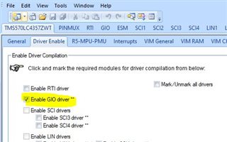

    2. Select GIO module in "Driver Enable" tab

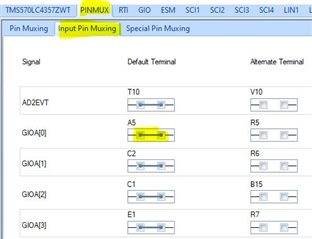

    3. Since there are two GIOA[0] terminals, please select which one for application

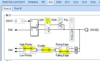

    4. Under GIO tab, please enable GIO interrupt, select the edge (for example falling edge), and interrupt level
    5. In VIM channel[32:0] tab, Enable GIO Interrupt High (VIM channel 9). If GIO Low INT priority is selected in step 4, please select VIM channel 23 (GIO Low)

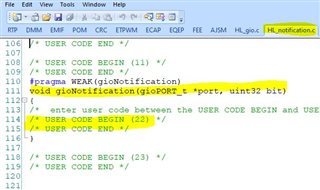

    7. The GIO Interrupt routine is generated in gio.c
    8. gioNotification() is added to GIO ISR. This function is for customer to insert their own code
