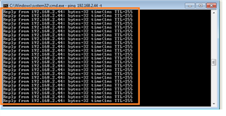

    I run the lwip demo on my launchpad, it works fine. My PC and the launchpad use the same network (connect to a ethernet switch).
    Here is the location for lwip demo code:
    http://software-dl.ti.com/hercules/hercules_docs/latest/hercules/Examples/Examples.html#lightweight-ip-lwip-demo
  • I just did another ping test, it works as expected. PC uses WIFI, and Launchpad is connected to my router.
    I was not able to insert a image file. This is the screenshot:
    I can ping my launchpad from my PC.

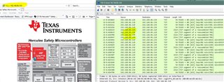

  • When capturing the packet with wireshark, please the retrieve the display image from192.168.2.44 (Launchpad will send the packet).
  • Herewith, I have attached the wireshark packet data. Launchpad is not transmitted any UDP (or) TCP packet data.
    We are able to capture the data with respect to ping request/reply(ICMP protocol) for the following IP=192.168.244.
    Like your wireshark data, we didn't get any TCP (or) UDP data.Can you check the same?

  • Wireshark can capture the TCP packets when I run TI lwip demo

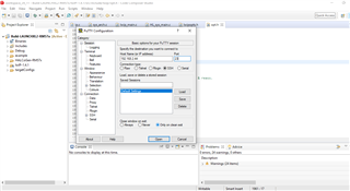

  • As I told you, refresh the connection to your board (192.168.2.44) after starting wireshark capture. Again, the MCU doesn't keep sending the packet to your PC, it only send the packet on demand.
  • We have run the putty terminal software in the laptop. Wireshark tool is capturing the TCP packet data from Lap top
    As you told, in this case the trigger is from the putty Terminal tool installed in the laptop.
    Below are the details,
                Laptop IP address=192.168.2.45
                Launchpad XL2-RM57 board=192.168.2.44
                Putty Terminal SW/Wireshark Tool SW are installed in the laptop
                Launchpad XL2-RM57 board <=> Laptop is connected with Cross LAN Cable
    After power up, the LWIP demo SW itself is not sending the any packet data by default.
    Since, the trigger from the Putty terminal SW for TCP packet data. LWIP SW flashed in the Launchpad XL2-RM57 responded.
    We are getting the above observed behaviour with Cross LAN cable (or) 1:1 LAN cable.
    Does this behaviour correct ? As per the LWIP demo SW, the SW itself cannot able to Transmit the TCP packet data. Kindly give your valuable feedback.
    Here with I have attached the Wireshark captured data & putty terminal SW.
      20210319.zip

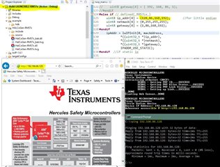

  • The problem is resolved. We should ensure the below things,
                # EMACCore0RxIsr(lwip_main.c)
                # EMACCore0TxIsr(lwip_main.c)
                # Run the wireshark terminal
                # Enable the webserver IP address(192.168.2.44) in the Internet explorer. You will be able to capture the TCP packets/IGMP packets in
                   the wireshark terminal software. I have configured the static IP address.
